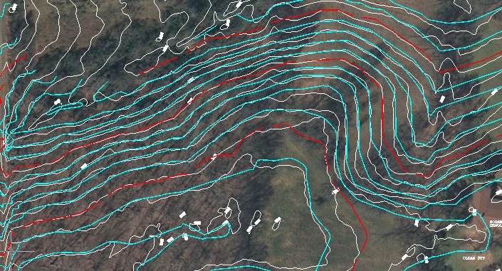

Here is a screen clip showing some recent LiDAR data vs topo collected by total station:
The red and cyan are total station and the white is LiDAR. Left side of the screen is pretty thick vegetation and the right side has several open fields. I haven't done any serious comparison on the data sets. Once you mentioned the inaccuracies from a few years back, I realized I had this data set sitting around. One strange thing to me is the red contour closest to the bottom - in the woods, the two sets of contour lines match well, but in the open area, they diverge a good bit.
The LiDAR data was collected at 5' horizontal spacing. Using the developed DEM, contours were generated at a 2' interval. No attempt was made at cleaning up the resulting contours.
The total station was random points where a line of sight could be established (shooting for +/- 50' grid and breaklines, but not always accomplishing that). Without doing the math on it, it looks like the LiDAR data is a pretty close match.
Since working with the two sets, I have often wondered if the sheer volume of data collected might make the LiDAR the more "correct" representation of the contours. After all, with traditional methods, exactly what happens between points relies heavily on the rod person's ability to choose the correct points to map.
