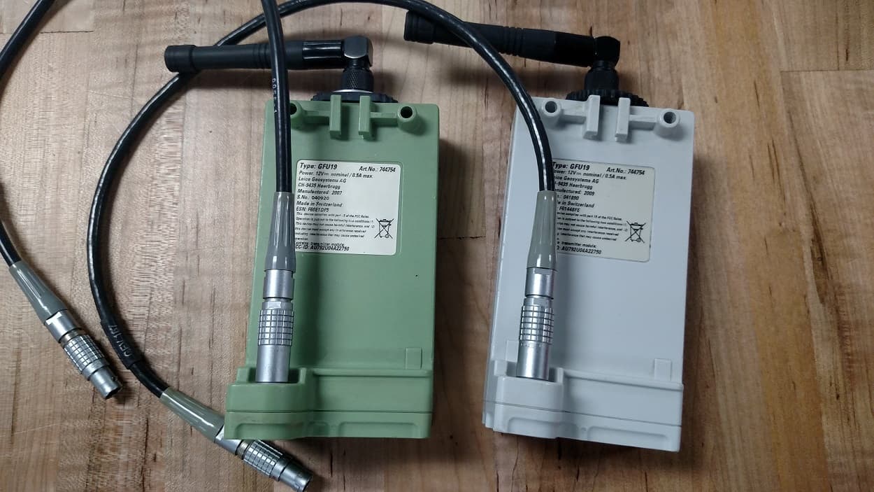

Leica has an external modem that can be used. Get a M2M (machine to machine) plan through Verizon and it works fabulously. This is the same plan type we use for the internal modems in our CS20 controllers. It's about half the cost of a regular data plan on a MiFi. Only drawback is the controllers won't run as a hotspot so internet works great on them but you can't connect anything else like your laptop.
This is the GFU19 modem. I believe there are several other model numbers that do basically the same thing too.

Cameron Watson PLS, post: 378940, member: 11407 wrote: Leica has an external modem that can be used. Get a M2M (machine to machine) plan through Verizon and it works fabulously. This is the same plan type we use for the internal modems in our CS20 controllers. It's about half the cost of a regular data plan on a MiFi. Only drawback is the controllers won't run as a hotspot so internet works great on them but you can't connect anything else like your laptop.
I use those Leica housings, BUT I also have the gear they were designed for, System 1200... Work fine!
