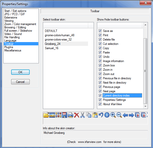

+1 for Irfanview. Our county has the oldest books scanned to tif files. The problem is, the entire book is in one file, and I haven't found a program that will let me go to a particular page without scrolling through the whole thing (including Irfanview). My solution is to turn the mouse upside down and roll the mouse wheel along my desk. You can go through a whole book in a few seconds.

Sometimes you just have to ask...pretty easy, just select the first number as shown below and change it to the page you want to go to, then hit enter.

imaudigger, post: 435775, member: 7286 wrote: Sometimes you just have to ask...pretty easy, just select the first number as shown below and change it to the page you want to go to, then hit enter.
I must either have a different version, or mine is set up wrong, because I don't have that option.

C Billingsley, post: 435903, member: 1965 wrote: I must either have a different version, or mine is set up wrong, because I don't have that option.
At least in the versions I have it is a toolbar setting which wasn't turned on by default last time updated Irfanview.
