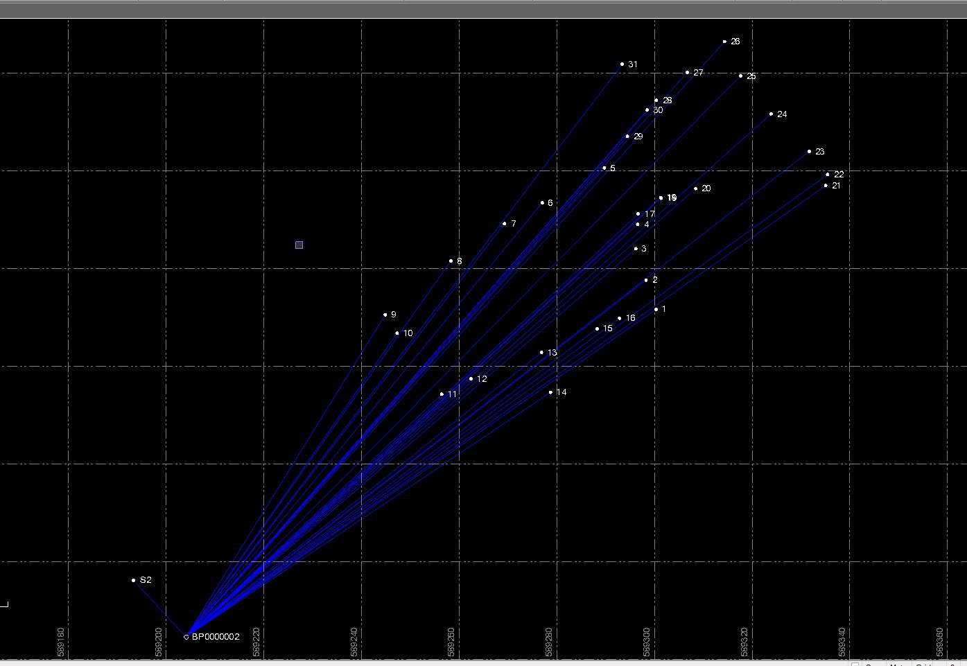

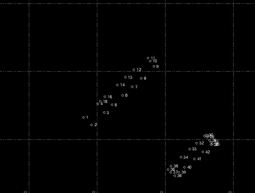

Hello to everybody. This is the 1st thread i post. I am using TBC (as an post processed and RTK office s/w) and Promark 500 and South Galaxy G1. Promark uses fast survey 3 and South Carlson Survce 5. When i import files from Survce, i cannot see any baselines from base station to points (see photo 1), instead when i import fast survey file i can see them. Do you know if there are any settings that i should change in controller?
Its important for me because i use an uknown base as base station and i give it control coords after post processing.
Thanks a lot

This may not be the answer, all the data I import into TBC is from Trimble equipment.
Look under view tab /manager/ and see if all the raw data is turned on. Just a guess.

What format is the SurvCE file? If this is static data we're talking about it needs to be RINEX.
The points in 1.jpg appear to have come in as coordinates (only). To see the vectors the file needs to contain the raw data and needs to be in a format that TBC can understand.

Both files are rtk data. The same problem was in fast survey v2 but when i upgrade into v3 it was fixed. The problem is that i cannot see the "base" point in TBC...So to give control coords and then recompute the store data points.
