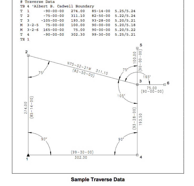

Thank you. I've used both of those before. BTW, would you know where/how these Star*net drawings can be produced?
I've seen them all over the manual, but can not find how to produce them anywhere in the program.

rfc, post: 341846, member: 8882 wrote: Thank you. I've used both of those before. BTW, would you know where/how these Star*net drawings can be produced?
As far as I know that's a drawing that was created for the manual to illustrate concepts rather than an example of application output.

Those drawings were in the manual when StarNet was DOS program with no graphic display output at all.
