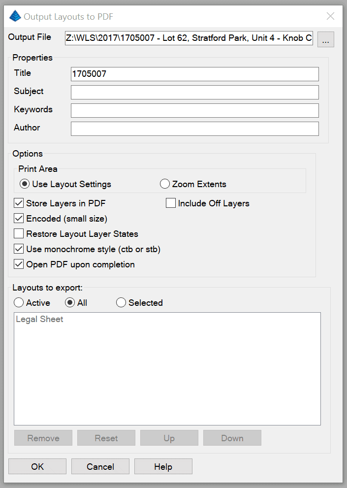

I use Foxit to edit and print PDF's, but since I also need a decent driver for Intellicad, I use PDFCreator to print to PDF and it mimics the small file sizes I am used to with C3D.
Without PDFCreator, I was getting ridiculously huge files. Foxit doesn't really work that well as a driver for CAD though if that is a consideration. Large File Size and it doesn't read in some of my text styles for some reason.
0.02'
Posted : September 14, 2017 8:03 am
stephen-ward
(@stephen-ward)
Posts: 2244
For what it's worth, the last few versions of AutoCAD include a printer named "dwg to pdf" or something similar that does a great job of plotting direct to pdf. Both AutoCAD and the latest version of Carlson on Intellicad 8.3 have a feature under the file menu where you pick PDF rather than Plot and you can create a pdf of multiple layouts simultaneously. I believe the command in Intellicad is "pdfexport", and here is a pic of the dialog box.
Pretty handy commands if you don't have a pdf writer that has a good CAD driver.
