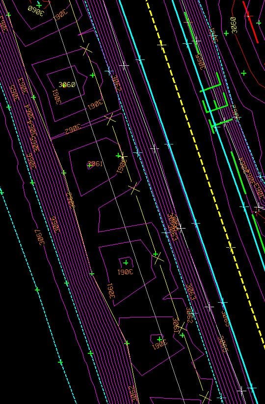

I've spent the majority of the last 2 weeks trying to rescue a poorly collected project. mostly collected as GRND, 14000+ points, 2300+ chains (1200 of them duplicates)..... 6.5 miles, ... I figured I was close to done so today I built the .tin and contours check.. I see I still have some stuff to connect.
My feelings on coding in the field......

Seems a bit odd, all of your contour elevation labels have 4 digits, are you on some kind of assumed datum? :8ball: lol

Rankin_File, post: 396378, member: 101 wrote: I figured I was close to done so today I built the .tin and contours check.. I see I still have some stuff to connect.
I've done just enough Microstation/Inroads to really appreciate the DTM editing functions of LDD and C3d, which Inroads lacks.

I was thinking the same thing... many surveys I do end up having negative contours. ..
