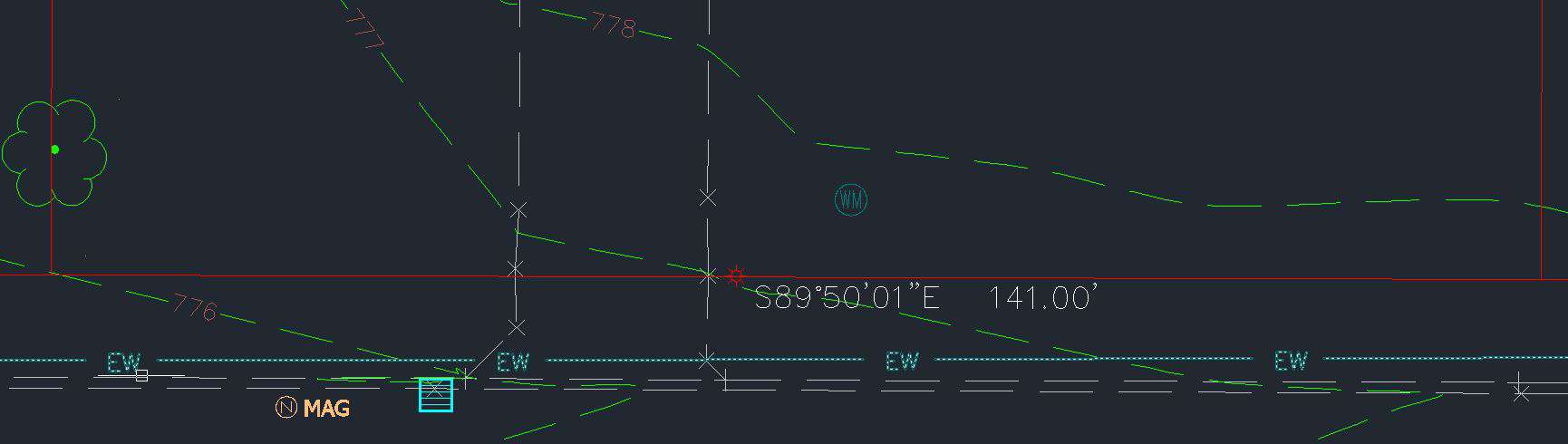

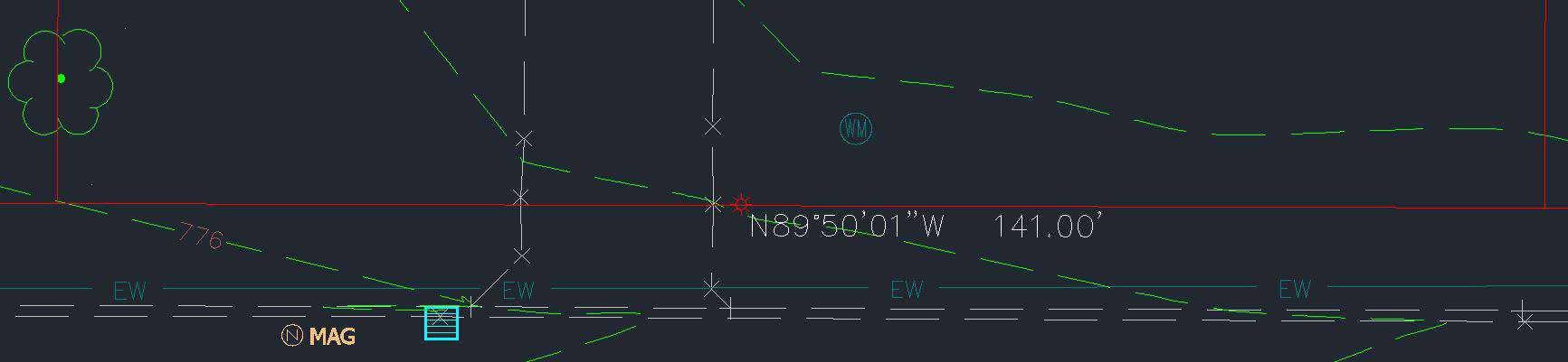

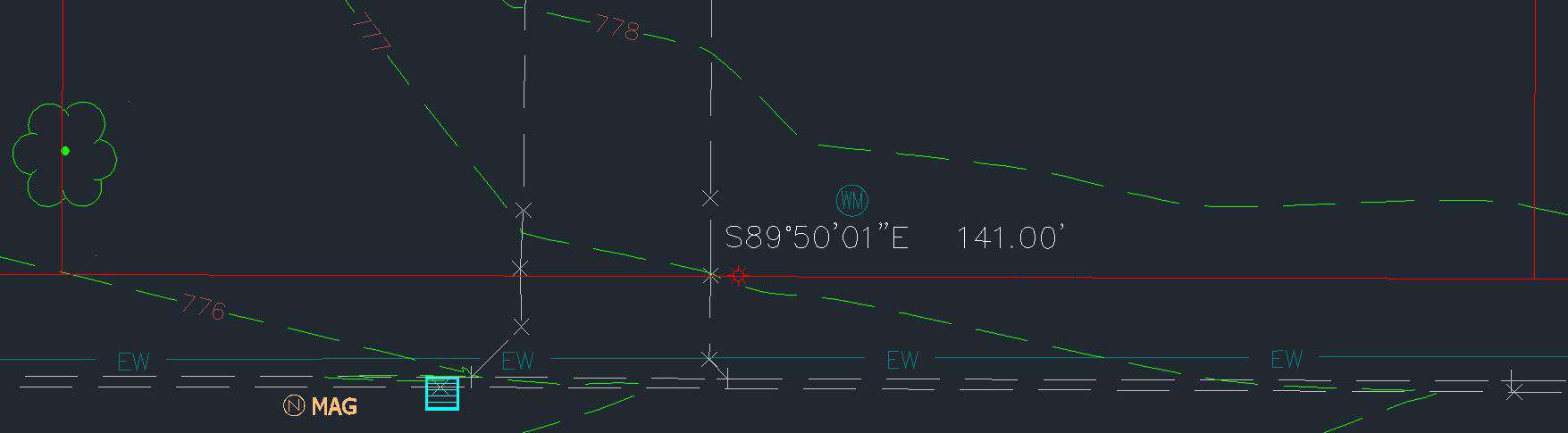

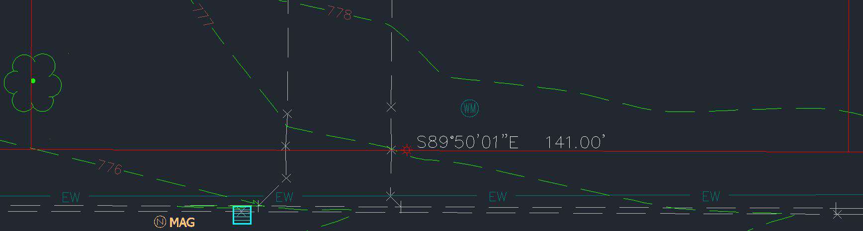

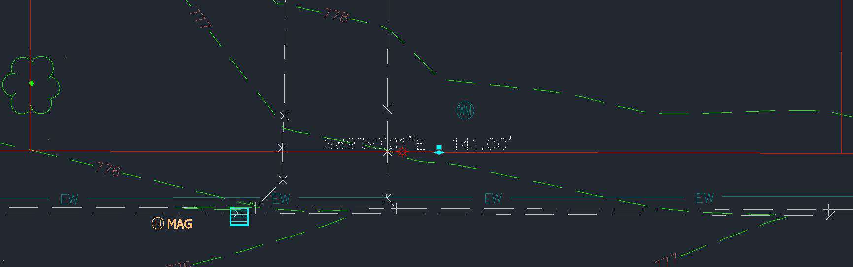

Image 1 shows a label with lines running through it, selected with grips. The top grip is for dragging the label, the bottom grip is for sliding the label. Image 2 shows the label dragged to a new location. As Dan Patterson noted, make sure you have your dragged state set to As Composed, and if you don't want a leader make you sure have the visibility set to False. Image 3 shows the label after sliding it from its original location to a new location.
If you right click on the label, you have options to flip the label, reverse the label, or reset the label. Image 4 shows the label flipped and Image 5 shows the label reversed. Reset is fairly obvious.
I'm not a surveyor, though I've been in the land surveying/civil engineering fields full time since 1982. I surveyed a couple of summers prior to that, and my dad used to take me to the office when I was as young as 12 so that I could plot metes and bounds or field notes for him. I'm a CAD guy. FWIW, I would be less concerned about the label changing as I would be that the LINE changed. Having dynamic labels is part of the checks and balances that are associated with having a good cad product. It can help you locate lines that missed getting trimmed or extended, and helps verify that your parcels are closed. It helps make sure your lines are drawn correctly and not just text put on a line that may or may not be drawn at the right bearing/distance. Carlson also has dynamic capabilities for annotation, and I use it in that program as well. In your particular situation, standing on the corner is correct that your drafter would have been better served by labeling using points rather than linework. I can't imagine taking away the dynamic capabilities of any object in C3D, which I unfortunately do not use any more. I honestly don't know if it's possible, except others say you can explode the objects, which I would NEVER do, nor would I ever advise anyone to do.
Your cad person needs more training, or at least to strive to make herself more educated about C3D. The reason the program has so many styles is that it gives you so much flexibility. I've never approached the 73 styles that standing on the corner lists, but I applaud the work he did creating them. He can change the appearance of his labels on the fly. That's a good thing!
