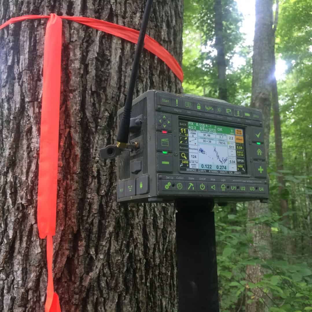

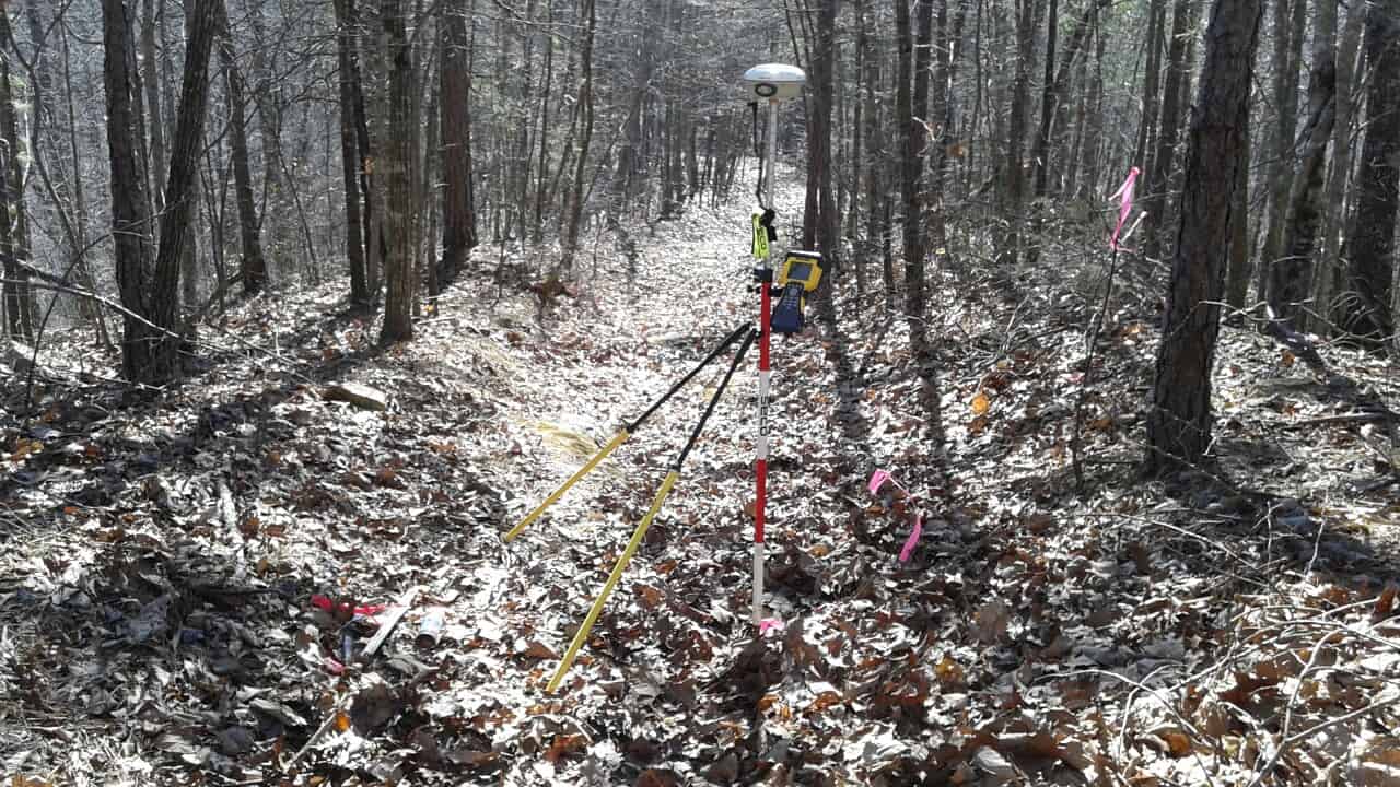

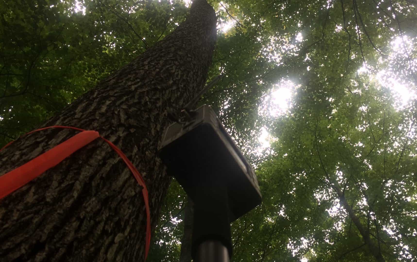

Well....this is another GNSS receiver under canopy using the VRS system....seems to be
operating fine to me...

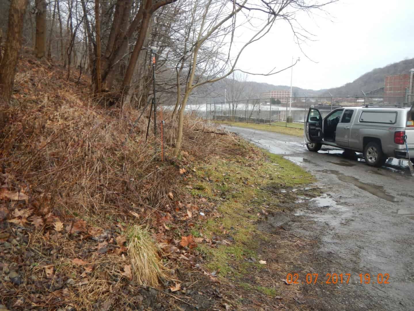

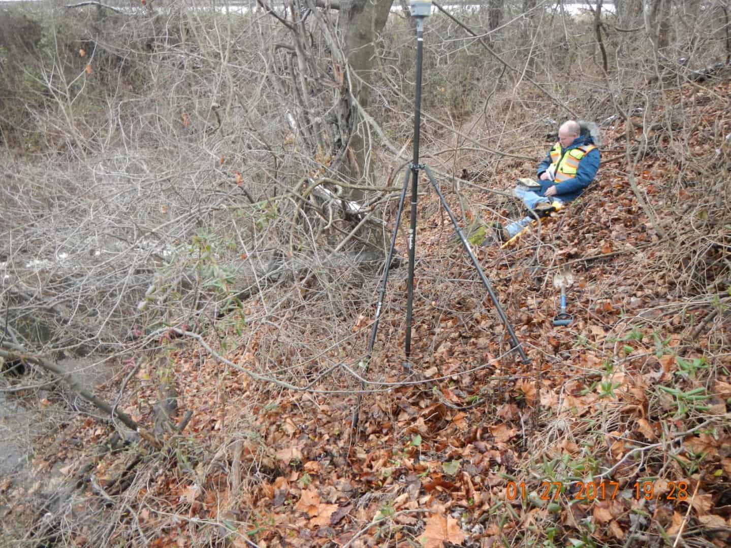

My recent experiences...I was locating some corners in the woods. Western PA winter, no leaves on but wooded area of deciduous trees. Trimble R10, VRS. If there is any doubt in my mind at all, we will do both a VRS and a total station shot. And I am always skeptical in the woods.
We initialized outside of the woods (corner was about 30 feet in). Occupied the point as observed control. Then dumped the init, and tried to re-init on the point (known point initialization). Kept getting about 30 to 40 cm, would not get any lower. Set a pair in the open, shot it in with TS. GPS position was off by about 10 cm. Multipath.
Another site, this time it was right on the edge of trees, but there was a high steep hillside to the west. First occupation aborted after 35 s, and it was 26 cm H and 55 cm V against the total station shot. Second occupation made it to 155s, it was 2 cm H and 5 cm V versus a total station shot from a pair.
I don't like to rely on GPS alone for an important shot in the woods (aren't they all important?). A few minutes is not enough time to get rid of the ugly effects of multipath. However, there have been times when there was no choice, for example no suitable open location nearby. In a case like that I will set one receiver in the open, and let the one in the woods run for a few hours (static, post processed). I have found that I can have high confidence in a situation like that, time will always triumph over multipath.

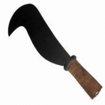

My former boss answer to this type of scenario would be
"Then get out your
and start making a path for your traverse lines!"
No such thing as "NO CHOICE"
