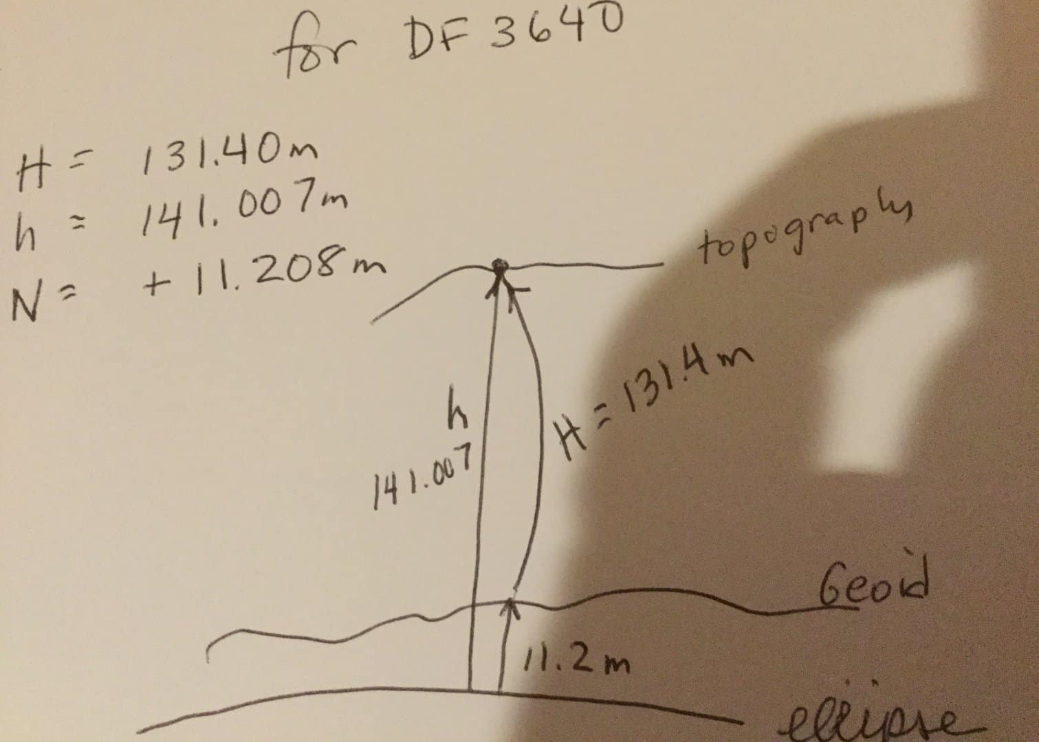

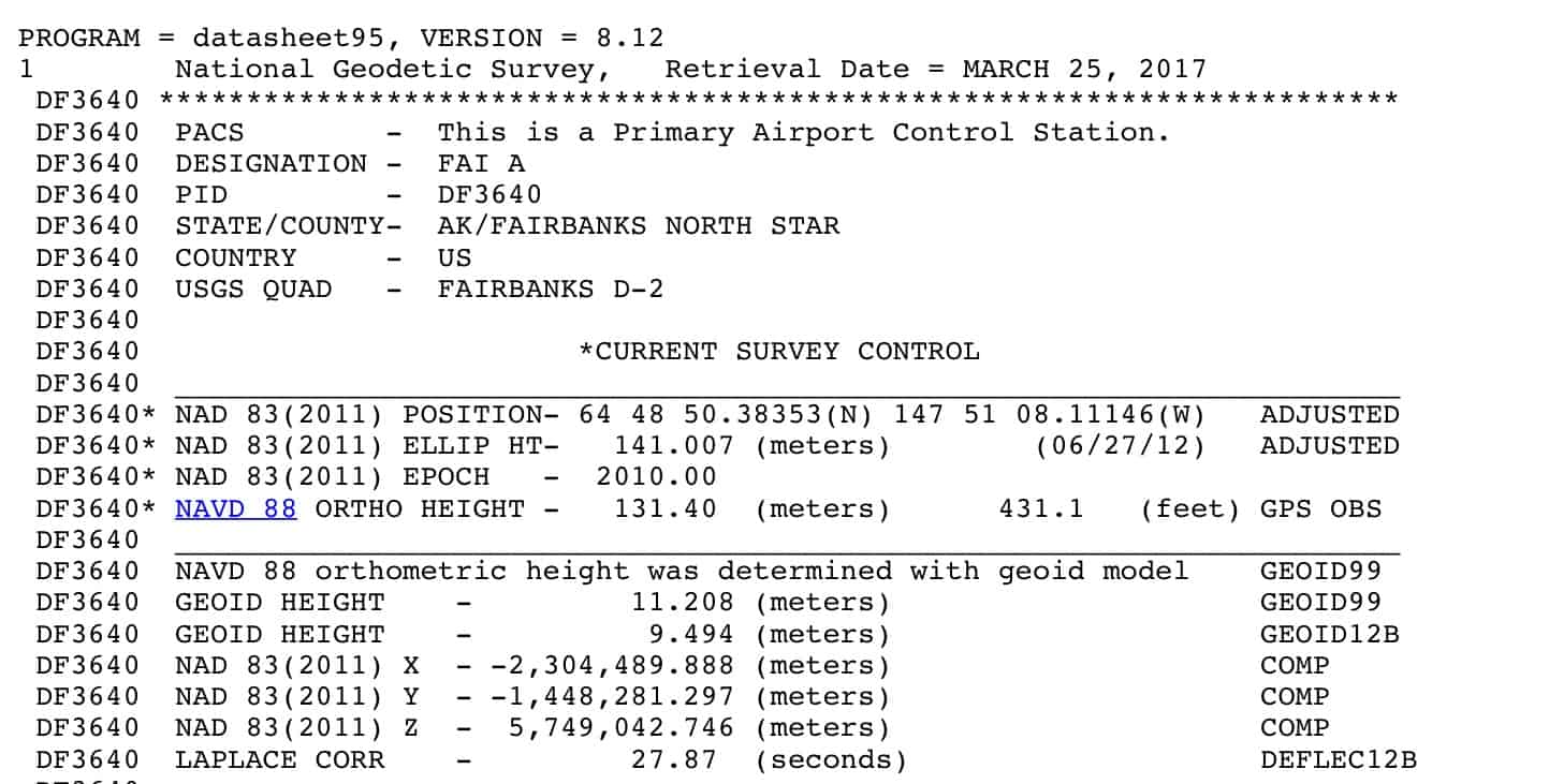

JOHN NOLTON, post: 420254, member: 225 wrote: Above in GeeOddMike post (note: when i looked at post by this person I always thought it was " Gee Old Mike" till I put on my close- up glasses) the nice picture is not correct---- at least for the conterminous United States.
Why don't they show a correct drawing of the relationship of the ellipsoid, ground and geoid. That should not be asking to much from NGS. The math is very simple but a correct picture is worth a 1000 words.
** In the conterminous United States the ELLIPSOID is ABOVE the Geoid. In Alaska the ELLIPSOID is BELOW the Geoid.
JOHN NOLTON
You are correct that the the drawing shows one of two ellipsoid-geodesic relationships. The point was in either case you need the separation.
Generically h-H-N=0

BTW, isn't Alaska part of the US?
