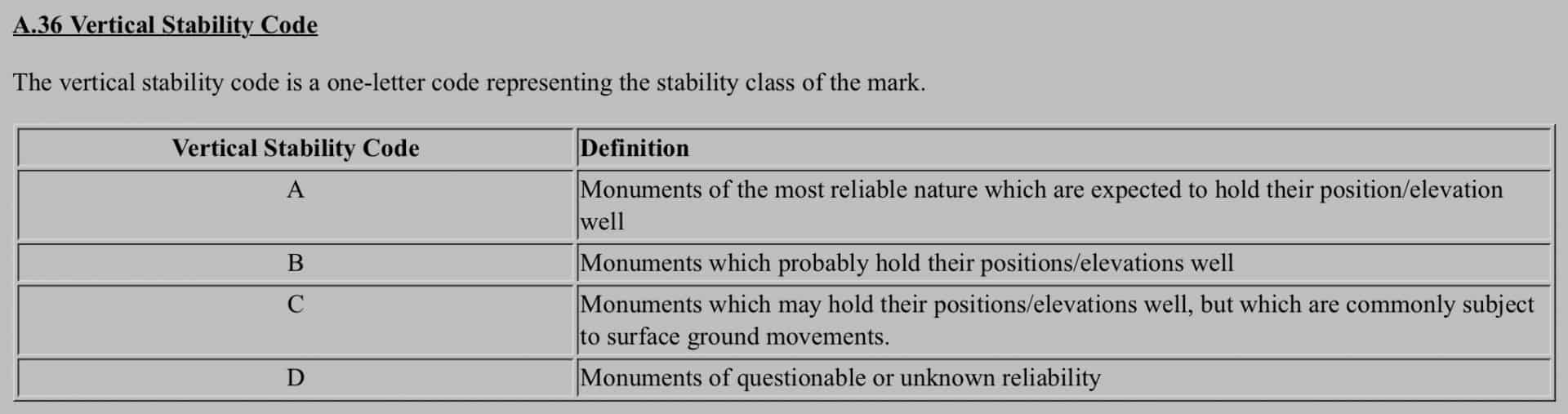

You will note in the image above ( https://www.ngs.noaa.gov/web/tools/updates/windesc5/dformat.documentation.htm#A.10 ) that NO monument is considered completely reliable. Unfortunately many submitters to NGS like to supercede these stability codes thinking their poured-in place concrete monuments are surely "B" stability not the "C" automatically assigned by the description software.
There are two separable issues: the variability of the monument (including susceptibility to temperature effects) and the variability of measurements. Since the accuracy of a least squares adjustment is dependent on the measurements containing only random errors it is incumbent on the submitter to provide sufficient data to allow for corrects and modeling of effects on the measurements.

Posts: 9977
GeeOddMike, post: 420075, member: 677 wrote: Unfortunately many submitters to NGS like to supercede these stability codes thinking their poured-in place concrete monuments are surely "B" stability not the "C" automatically assigned by the description software.
Would a solid-looking and 6 ft deep storm sewer inlet structure rate a 'B' ? An abutment or wing wall for a small bridge?
Posted : March 24, 2017 1:17 pm

Bill93, post: 420134, member: 87 wrote: Would a solid-looking and 6 ft deep storm sewer inlet structure rate a 'B' ? An abutment or wing wall for a small bridge?
I like the guidance in https://www.ngs.noaa.gov/PUBS_LIB/GeodeticBMs.pdf
A six foot deep structure in Minnesota might not be very stable.
Posted : March 24, 2017 2:47 pm
Had a little issue arise while composing my response. While I do recommend review of the NGS linked above, my comment about stability codes were intended to highlight the fact that such codes are too subjective. I have worked with folks who do searches with stability codes as a high priority. Like the satellite visibility notes and others on the NGS data sheets, with the influx of data from non-NGS sources I have seen these values become less useful.
Of course, I always wondered about the accuracy of the "pack times" in old descriptions. I always seemed not to meet or exceed their times. Pack times were in descriptions of monuments requiring one to leave their vehicle and "pack" their equipment to the site. Nowadays people want monuments in convenient locations and do not need to worry about intervisibility. I always liked packing equipment to remote high sites with great views and splendid isolation.
