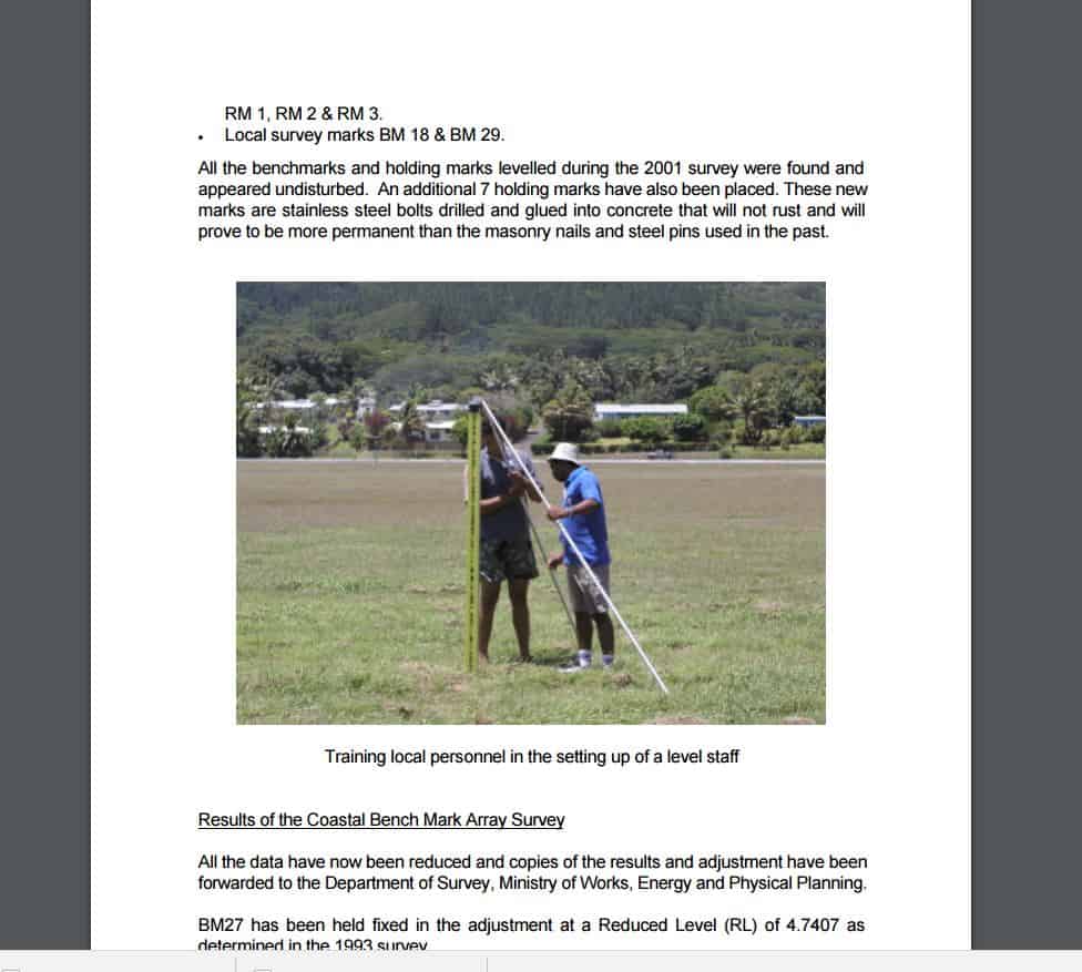

I saw a similar scene below here in Fiji from the sea level rise monitoring in the southwest Pacific. From memory the guy I saw was probably Australian and from internet research was doing a maybe 2km loop as part of the process of checking whether the sea is rising or the land at the gauge is dropping. I saw him on two consecutive days, and I think he'd advanced maybe 500m. Serious stuff.

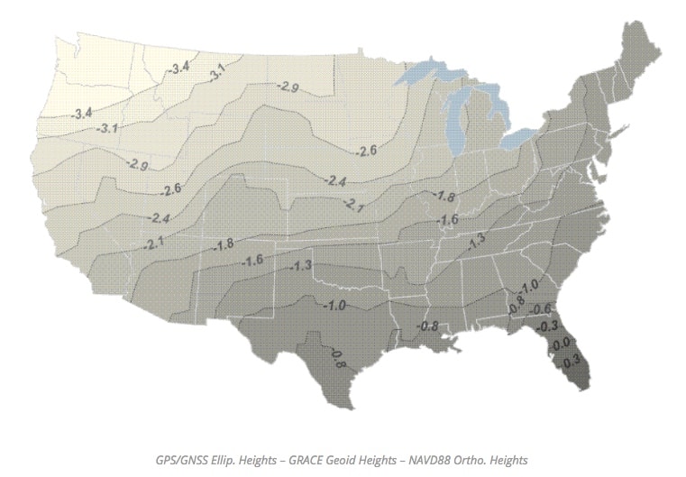

As for the the general issues raised by this thread, the monumented network of benchmarks in the US is not verified as it is not maintained It will NOT be re-leveled. The physical monuments, as noted, are subject to all manner of processes both natural and man made.
As for the specifications in the US, they provide guidance on how one meets a standard. As noted the specifications detail a wide range of procedures and equipment characteristics. As Mr Hamilton stated, leveling is simple until you try to do it rigorously.
When we talk of geodetic leveling I always recollect the statement in "Physical Geodesy" by Heiskanen and Mortiz who state that: "Leveling without gravity measurements, although applied in practice, is meaningless from a rigorous point of view, for the use of leveled heights as such leads to contradictions..."
The issue of inappropriate accuracy demands (the example posited of a bathy survey requiring a first-order tie) is the result of uninformed contract specification writers.
I always hated involvement on large leveling projects. It was dull, repetitive work that required careful attention to detail. I was lucky to move to more interesting tasks.
The move to GNSS-derived ellipsoid heights plus a high-resolution geoid model is the proper path. If you want to see the monumented network re-leveled and monitored, who is going to pay for it? The scale of the job is beyond the resources of national agencies. The cost would be enormous.

My interest is more on the CONUS-scale issues discussed in articles like this: http://www.spar3d.com/blogs/from-scratch/replacement-north-american-vertical-datum/
Note the systematic tilt in the following image:

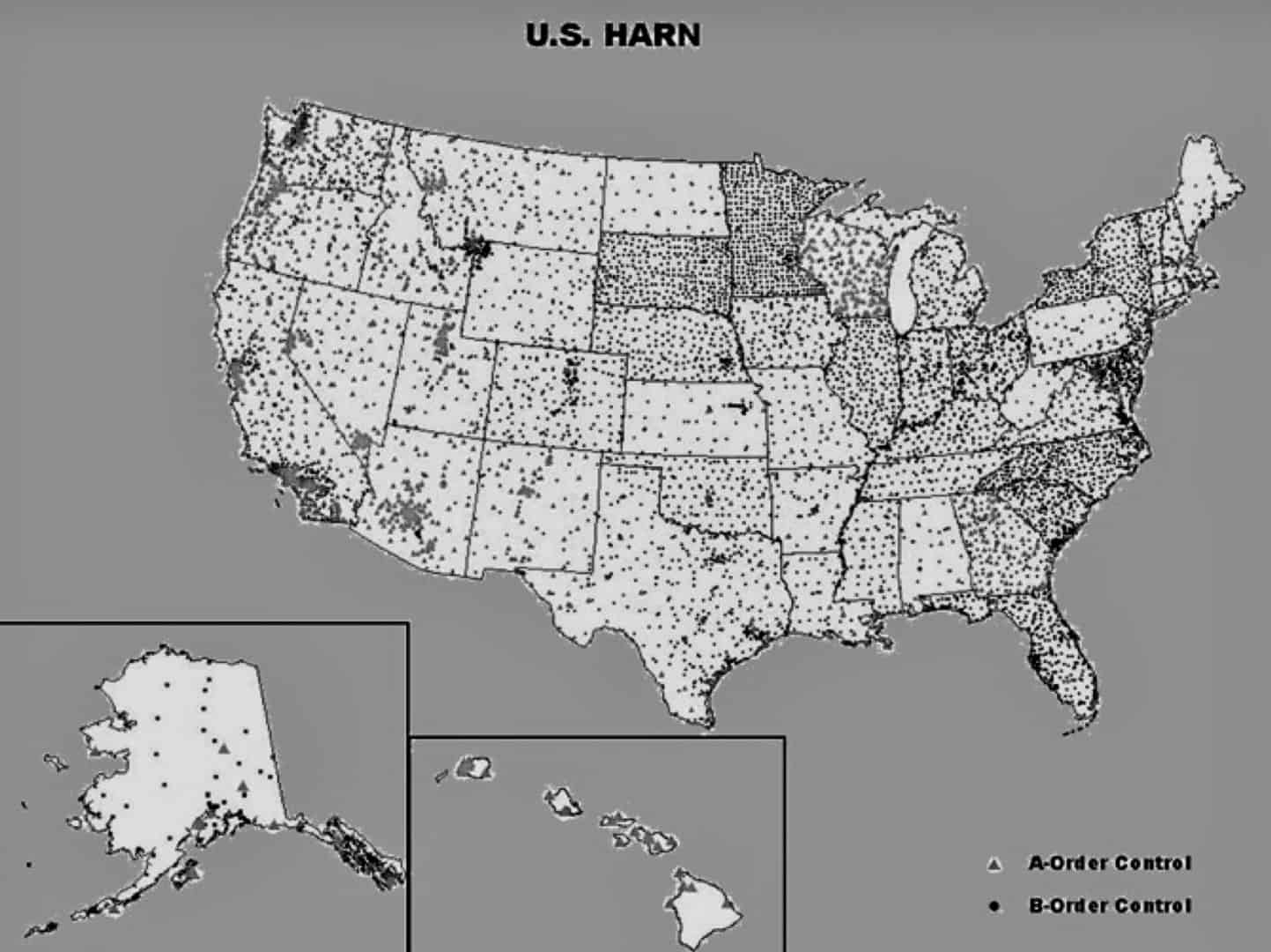

Glad to hear that Illinois has seized the initiative. Unfortunately most states will not. Looking at this map of the highest horizontal accuracy ground monuments in the US shows great variation in the interest and capability of states when it comes to their geodetic infrastructure. Vertical control is even harder to get done.
