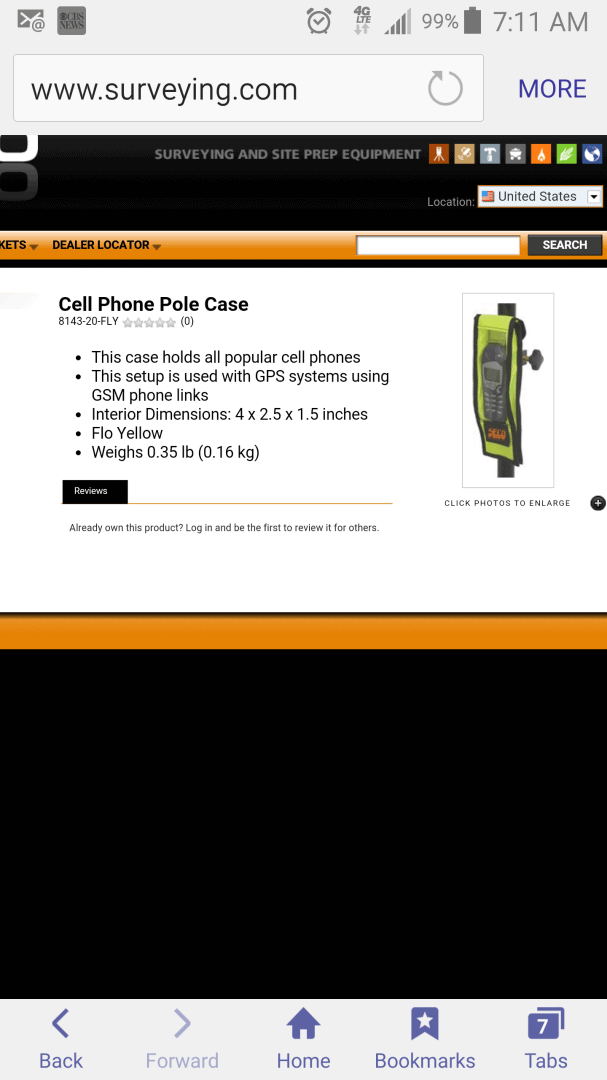

N.W. Staker, post: 389612, member: 11801 wrote: I wasn't aware the jet packs have an option for an external antenna.
?c=2'">5 dB antenna for Verizon Jetpack

Rob S, post: 389638, member: 11901 wrote: This works great for me.
Using that at an unattended base station seems likely to result in someone else owning your phone. My plan is to lock the Jetpack in a Pelican case that's bolted to the base receiver tripod, thus discouraging at least the casual thief.

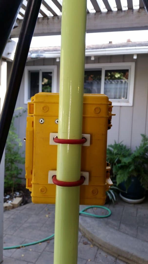

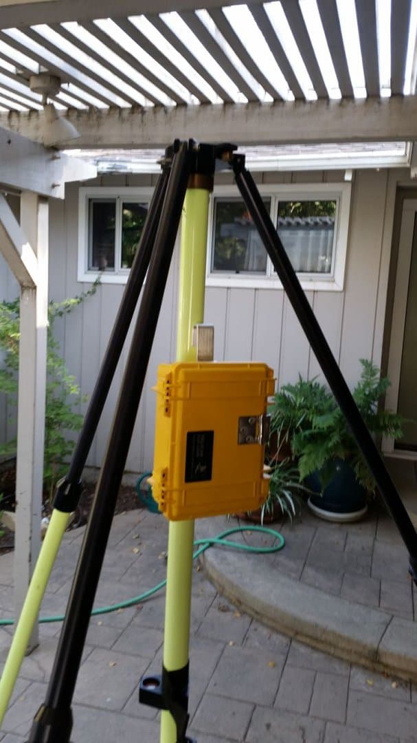

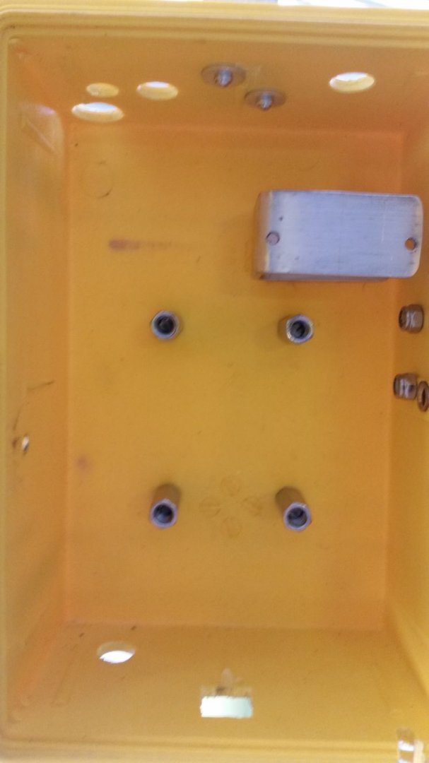

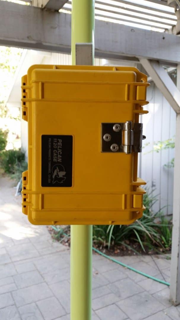

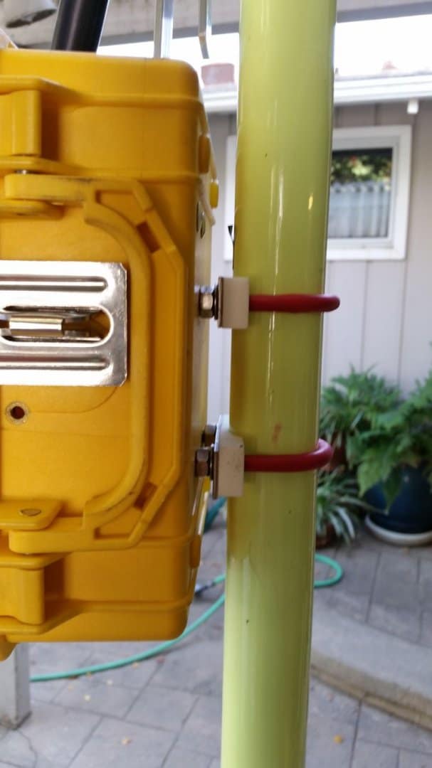

Whilel waiting for the replacement Jetpack to arrive, I repurposed a Pelican case that I used to use with a Geodimeter robot to house the radio. A couple of stainless steel U-bolts, some heat shrink tubing, a couple of 3D-printed clamp brackets, some nuts and washers, and the Pelican case rount out the new installation. The U-bolts and brackets stay on the tripod, and the coupling nuts are finger-tightened to secure the Pelican case during use. There's enough room in the case to hold the Jetpack and an external battery pack, if I ever need one.
