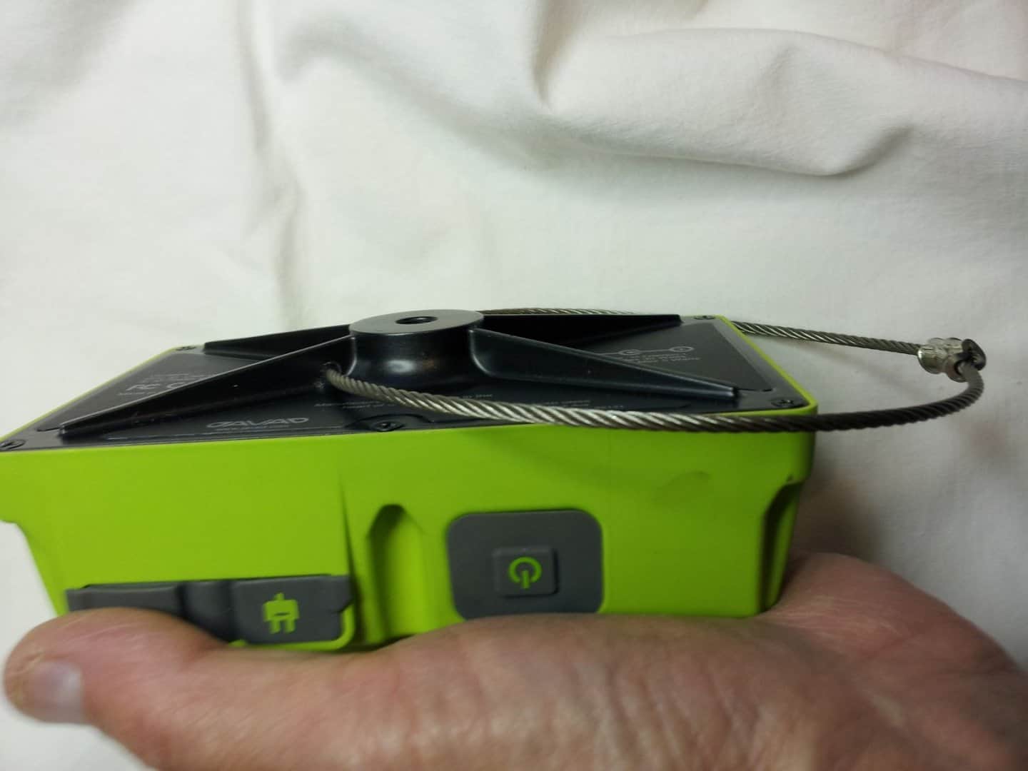

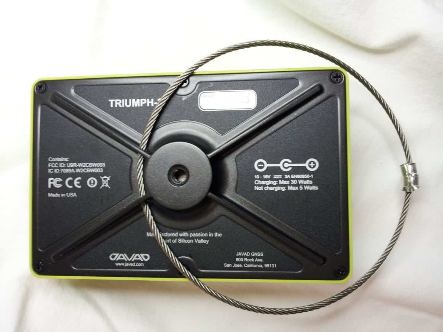

Nate The Surveyor, post: 343304, member: 291 wrote: Jim, I cannot see your pics
Hmmm...I wonder if you have to be logged into the Javad site for those to show up.
Here are copies:
Posted : November 6, 2015 1:54 pm

Did you drill the holes or were they already on it?
Posted : November 8, 2015 6:22 am
