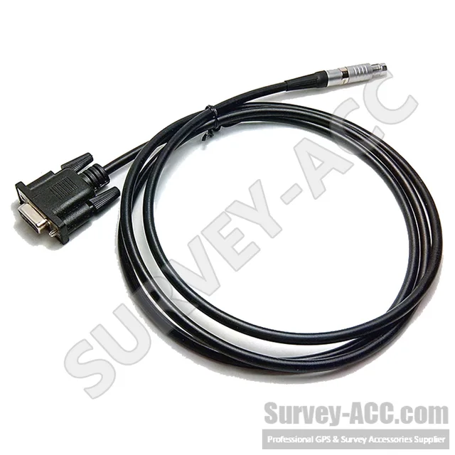

When I was developing this app I primary think about really old equipment like Topcon GB 1000 or Trimble 5700. A lot of this receivers are still in use at nowadays. Serial ports data transfer is the main way of communications for them. And their owners have all necessary cables.
Your case is a little bit different, you have a pretty new equipment and Bluetooth is the defacto standard for them. I will definitely add Bluetooth support at next version of YCServer.
You will need 3 type of cables to pair Hiper V with a phone:
- RS-232 to 7 pin Data Cable for Topcon GPS (It should be included in standard package of Hiper V)
- Usb to serial adapter
- USB to micro usb

David C. Newell RPLS LS CFM, post: 439429, member: 6347 wrote: Do you have a list of cables needed for 5700?
TIA
dcn
5700 also need 3 cables
- Trimble GPS Data Cable Lemo P/N 32960
- USB to serial adapter
- USB to mini usb
