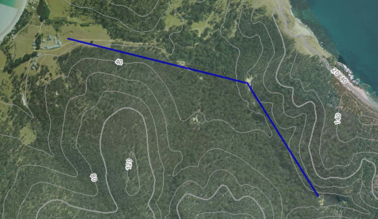

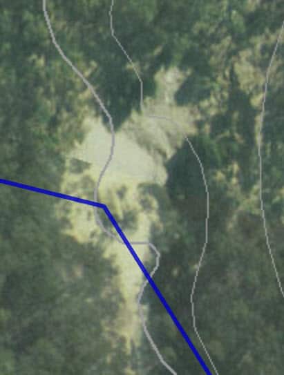

rplsntx, post: 428272, member: 8904 wrote: what kind of range did you get with the internal radio?
I didn't have an opportunity to test it but I was concerned.
The job (at Maria Island on east coast Tasmania) was part up a valley, heavily timbered and about 1.8 km from open country where I setup my base for the job elsewhere.
I broke it in two as the terrain and the timber prevented a signal getting through.
I managed the first at only 800 metres but that was fortunate as it was down the valley. The open ground there was not very large and I had limited places to put an intermediate. Fortunately worked well and I repeated same twice on two days and was rapt with the result. (the agreement or figures it spat out!)
Other leg was 1 km.
When I picked up the GPS the bloke leasing ran me through procedures,
We were able to pick up a few network bases around southeast Tasmania. One was near the job about 160 km away,
As there was proper control on the island I was working on I stuck to my 14/15 setup.
below was the intermediate base
This was the work area.
The bush I surveyed successfully in was southwest of the left side of baseline end
there are 3 houses up there and underground services, never did I get a poor fix in tracing those service lines.
As said, I was very impressed.
In my case if I was to purchase I would not hesitate to buy from the person I dealt with, but that comes with many years of dealing with that firm and the excellent service in regards to Leica GPS from him and Leica Australia (C R Kennedy)
