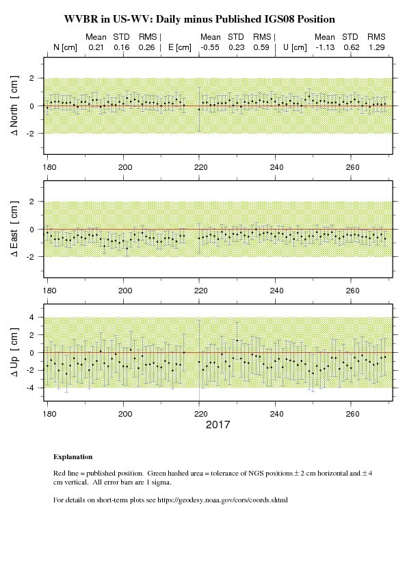

I think they let these things go too far. Here is one that I use a few times a year...

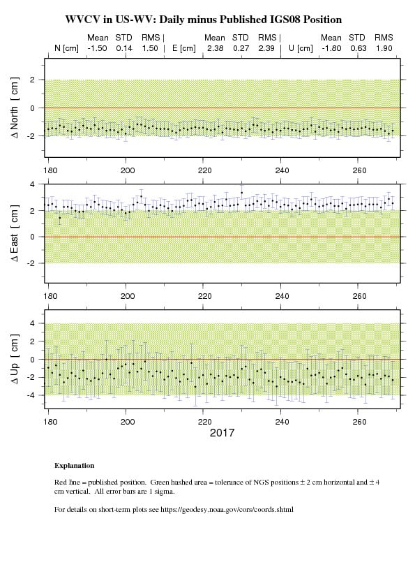

And another one nearby, not so far off...
My deformation project is about 1/2 way between the two. The deformation survey uses local monuments, but we use these two CORS as an external check on one of the monuments TYGART ASE2 PID=DL1902). Yes, I can use the short term plots to compute a more accurate coordinate, but why should I have to?
So, my question is, do you think NGS should update CORS coordinates more frequently (i.e. smaller tolerance)?

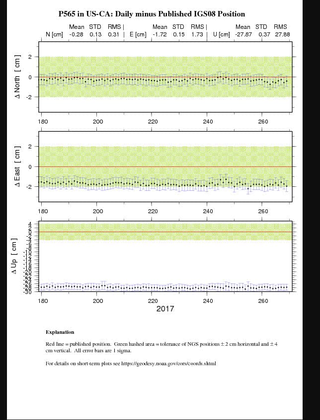

Posted : September 29, 2017 8:15 am
This one is near me. I have to exclude it every time I submit to OPUS or OPUS Projects.
Posted : September 29, 2017 8:18 am

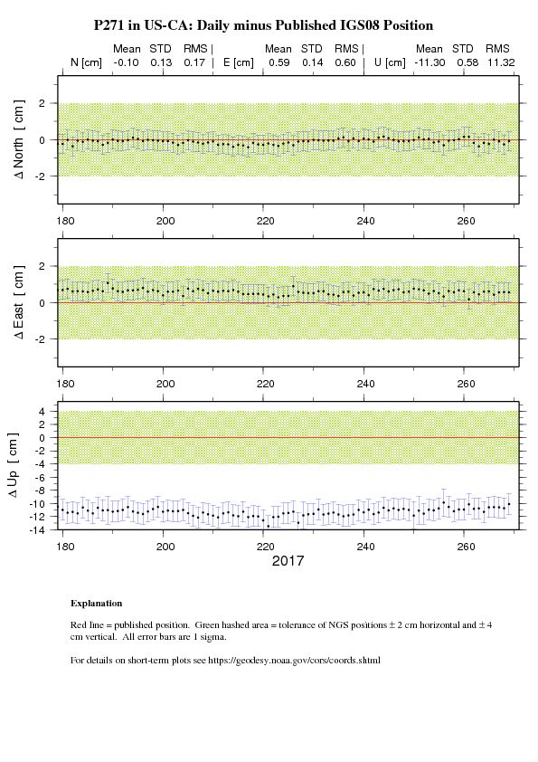

Jim gives a good example of one in Northern California that is way out of tolerance in the UP component. Here is one in the lower San Joaquin Valley that is about 2.5 times worse. Yes, NGS needs to do a much better job of updating the positions on CORS stations. As John Hamilton said, the SOPAC tool SECTOR is a great way to check daily positions versus a published 2010.00 epoch position.

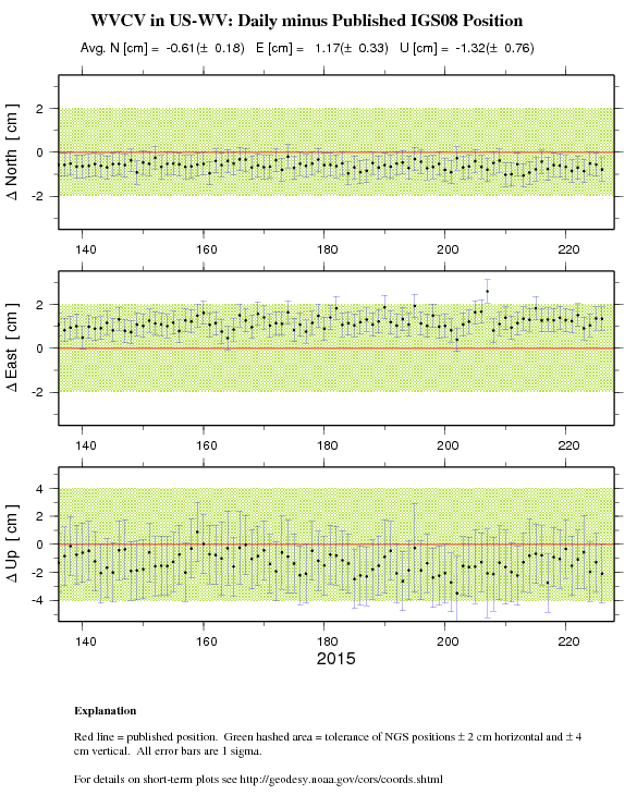

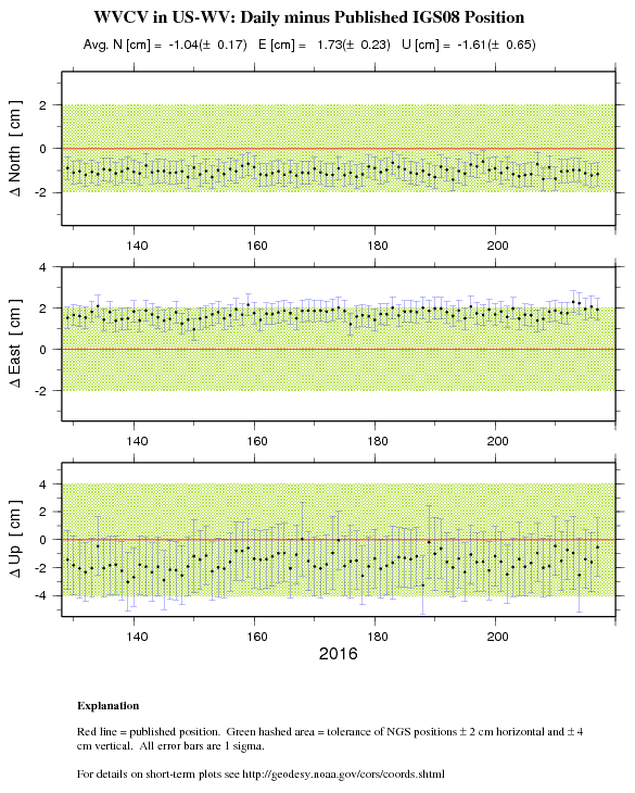

For John's example of CORS station WVCV, it may be that instead of upgrading/revising the coordinates the better solution would be to revise the velocities. The coordinates page for WVCV states that the IGSO8 velocities were, "Predicted with HTDP_3.1.2 Aug 2011.", which means that the vertical velocity is set at 0.0 mm (well, actually the velocity is 0.0001 m/yr on the coordinates page).
Below are short-term plots in September 2011 and August 2013, 2014, 2015 and 2016. The drifts in NEU (esp. the last 4 years) indicate (to me at least) that the HTDP predicted velocities are the [main] source of the daily minus published IGS08 position residuals. John has stated that he uses local CORS stations and does his own post processing. I would suggest that he adjust the published coordinates for WVCV by -1.5 cm, 2.38 cm, and -1.8 cm for his current project. At least until the NGS updates the predicted HTDP velocities, or preferably computes the velocities using data through gpswk ????.
A cautionary aside: I did not look at the site log or all of the short-term plots so there may be a "jump" in the data from the replacement of an antenna, etc. that has contributed to the residuals.
Old 60-day plot, Sept. 10, 2011. Notice that U(cm) = -1.76
Short-term plot, August 11, 2013
Short-term plot, August 4, 2014
Short-term plot, August 17, 2015
Short-term plot, August 8, 2016

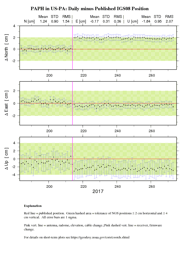

Here is another one...
On August 2, 2017 they changed the receiver from a LEICA GRX1200GGPRO to a LEICA GR25, and the antenna from LEIAX1202GG to LEIAR10. I assume they put it on the same mount. Note the jump in position...
Now, maybe I misunderstand the purpose of antenna models, but shouldn't the antenna models take care of these differences?
Maybe they are waiting until X number of days with the new receiver/antenna to update the position?

Posts: 10694
I wonder how an antenna change could shift it an inch
