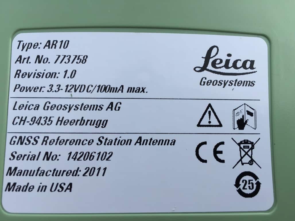

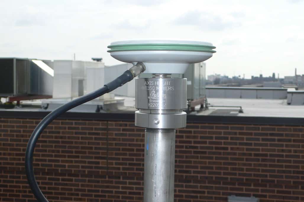

John, It looks like NGS has only updated some of their photos. This is a Leica AX1202GG antenna and included in the photos for PAPH.
They also have a photo of the serial number which is for the AR10?!?
And this is a photo of the Leica AR10 antenna with radome.
