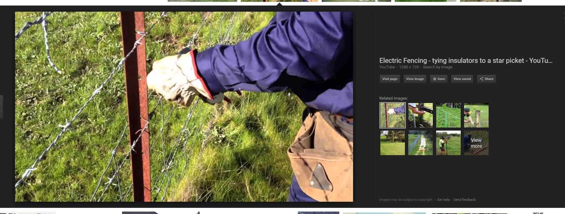

Richard, post: 435406, member: 833 wrote: One had a star marker
That's the second reference you've made to a "star marker." I'm not familiar with it, and an image search turned up nothing likely. Can you descirbe a star marker, and maybe post a photo of one?
Posted : July 5, 2017 5:36 pm
dick emery
(@dick-emery)
My guess would be a (piece of) steel star picket fence post, aka y-post, waratah:
We've seen a few of those here in Fiji, set in concrete, top about 0.75' below ground level.
Posted : July 5, 2017 5:58 pm

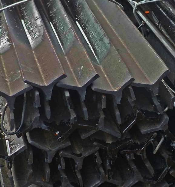

[USER=10]@Jim Frame[/USER] the other Richard is right on. They're properly called star pickets, but we also in survey use call them star markers when they are placed alongside a permanent mark of some description.

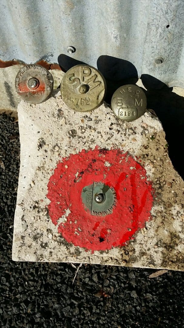

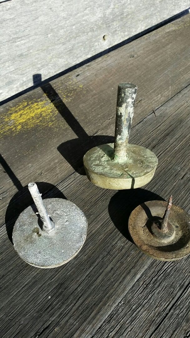

Below are some old permanent marks salvaged from demolished areas.
These show various types and ages.
Solid brass mushroom probably from the 40's?
Lighter discs about 80's
Other smaller mushroom mid 50's. It was part of a levelling run probably 30 miles long. Quite common. Now rapidly being lost or obliterated.
The concrete was an old culvert headwall now replaced.
The star pickets are commonly used for fencing, construction, surveying, landscaping

Richard, post: 435480, member: 833 wrote: They're properly called star pickets, but we also in survey use call them star markers when they are placed alongside a permanent mark of some description.
Around here we just call them steel fence posts, sometimes studded-T fence posts.
