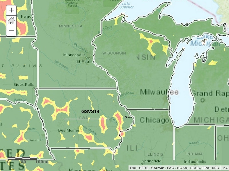

I'm trying to attack the streak of red marked with the arrow in the following picture, and three of the points tabulated above fall in or beside it. My green circles would fall just short of Illinois, leaving a yellow tip. I also need to do a session on a culvert just east of that streak as a check.
Two of the points tabulated above are near the southern tip of the streak to its west, which along with the GSVS14 study should eliminate the red there. I've done some looking for marks near that blob in south central Iowa, not too far from my home town, and have a couple ideas for sessions but they are difficult (need rather tall antenna pole) or risky (20 ft from very active track).
Posted : November 13, 2017 11:10 am
Posts: 10008
I shouldn't be using words like "eliminate red" because my data won't actually be used in a new geoid. But it could provide checking in an area that needs it, so I think in terms of covering those areas with circles.
