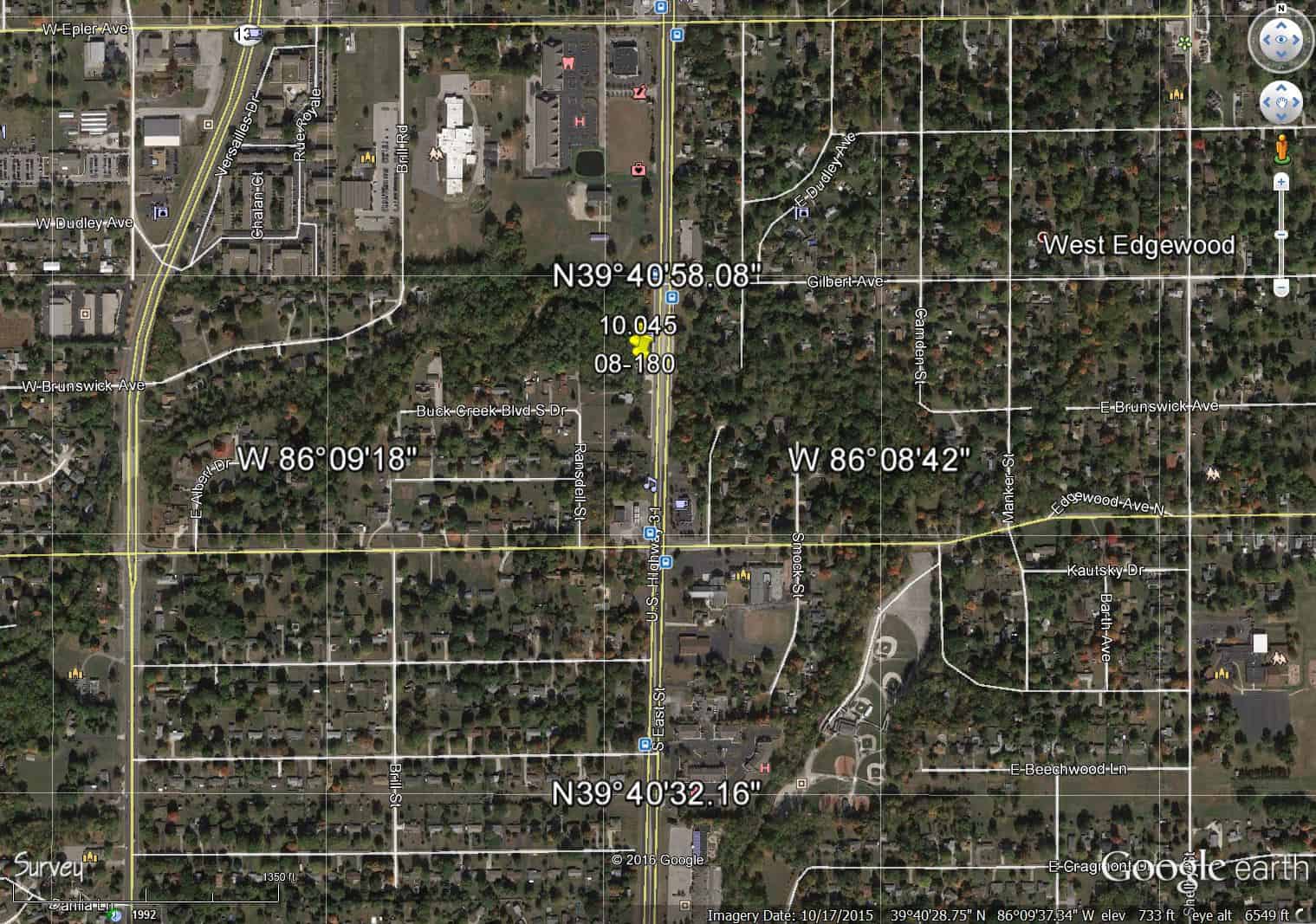

Question: What is the best tool for calculating the anticipated vertical difference between the 1929 and the 1988 datum for a given location?
Say such as here, for example?
I started to look into downloading Corpscon to my new pc, but it looked like a buggy and clunky download, so I wondered if there is something more modern available? Maybe my Carlson software will do it?...

I use the data sheets for that, the shift (at least where I am) is usually pretty consistent over a fairly large area; not like a geoid height which can change rapidly.
A quick look shows about -.45'; a 29 elevation of 600.45' will become an 88 elevation of 600.00'. You can check against some conversion programs but the real data is always good to see and I figure what's on the data sheets is what we use anyway.

You could try this. Seems to work well.
http://www.ngs.noaa.gov/cgi-bin/VERTCON/vert_con.prl

My preferred method is to download datasheets for 2 or 3 monuments surrounding the current project site which have both '29 and '88 elevations (per levelling) on them. Calculate the differences, compare, and usually use an average difference.

It looks like there isn't a lot of change within a few miles of your place mark. An ADJUSTED line runs about 5 miles north so I think the VERTCON should have been calibrated to that. To the south you have to go further to get many bench marks.
At 4.5 miles NW
KA0131 NAVD 88 ORTHO HEIGHT - 211.527 (meters) 693.98 (feet) ADJUSTED
KA0131 NGVD 29 (??/??/92) 211.665 (m) 694.44 (f) ADJ UNCH 2 0
chg -0.46 ft

VERTCON is the official tool to compute shifts between NGVD29 and NAVD88. It is a model based on actual measured differences between points whose heights were determined in each datum. It is not intended to (nor will) provide geodetic quality results.
CORPSCON is an interface for NGS programs VERTCON and NADCON and GEOID and SPCS and UTMS. All these programs (and more) are available in the NGS Toolkit. The USACE is to be commended for combining these individual tools into a user-friendly tool.
For a description and explanation of program operation see the preprint of an article that appeared in Professional Surveyor here: http://geodesyattamucc.pbworks.com/f/VERTCON4ProfSurveyor.pdf
The article includes some advice about determining its applicability in an area. In short, compute shifts around your project area and examine them to see whether they are consistent.
