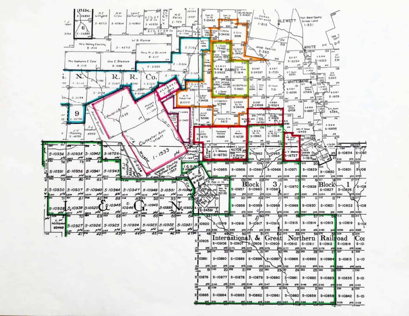

While I realize that elsewhere in the US it is a major exercise just to lay out a modern small lot subdivision to anything resembling modern accuracy standards, in Texas we get to deal with somewhat more difficult problems. I spent today writing up the history of this area where Maverick, Kinney, Uvalde, and Zavala counties meet in Southwest Texas. It is a large-scale jigsaw puzzle mostly created in the period between 1849 and 1932 where many of the puzzle workers didn't even have a good picture of what the whole thing was supposed to look like. One County Surveyor apparently thought it was a picture of Heidi Klum while another thought it was one more episode of Hollywood Squares. Only in Texas.

What do the color outlines represent? System or surveyor or ?

Andy Nold, post: 381741, member: 7 wrote: What do the color outlines represent? System or surveyor or ?
The color outlines identify systems and pseudo-systems, i.e. a series of surveys made by the same surveyor, although not with the same chainmen and or as a truly continuous operation, the reasonable assumption being that the surveyor knew where he had run and marked such lines as he had earlier and so would not be mistaken about their relation to his later work supposedly connected.
For example, the pink outline encloses surveys made in March and May, 1874 by John James, listing the same two chain carriers for both. However, the May location (the Edward Brown Survey No. 4) calls for no identifiable corners and appears to be entirely protracted from his work in March that located the Hester Ann Catlett Survey No. 1 and the Moses Wood Survey No. 2.
Posted : July 19, 2016 10:39 pm
BTW, the I.&G.N. R.R. Co. Block 9 outlined in blue was originally surveyed by A. wyschetski who I would say was probably one of the more competent railroad surveyors of the day. I'd be mildly interested to know the rest of his bio and will probably look him up on ancestry.com.

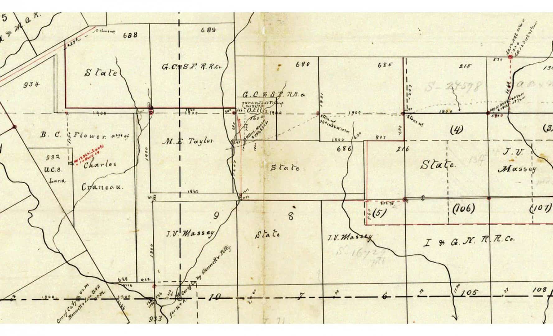

This 1887 sketch by Maverick County Surveyor O.H. Hector (ref: GLO Uvalde County Sketch Files 12 & 12a) shows a pretty good attempt to sort out the confusion.
Unfortunately, it may not have gotten recorded in Kinney or Uvalde Counties. If it did, I'm not sure why later surveyors didn't realize that there were two rows of rock mounds about 100 varas apart, one of which was the original South line of Surveys Nos. 688 and 689 as located in 1881 and the other of which was a baseline run in about 1874 or 1875 by Jacob Kuechler in connection with other work entirely.

In that particular case, the confusion was in part the unintended consequence of trying to keep the pattern of surveys orderly by restricting the authority of surveyors to make surveys only within certain land districts. As a result, after 1875, only the County Surveyor of Uvalde County (who was also the District Surveyor of Uvalde District) or his deputies could locate land scrip in Uvalde County. So the some of the surveys made by F.M. Maddox as Deputy Surveyor of Bexar District as a part of the series outlined in red (locating some land scrip issued the the river contractor, J.V. Massey) were invalid by reason of being completely inside Uvalde County and in conflict with junior, but valid, surveys made by a properly authorized surveyor.

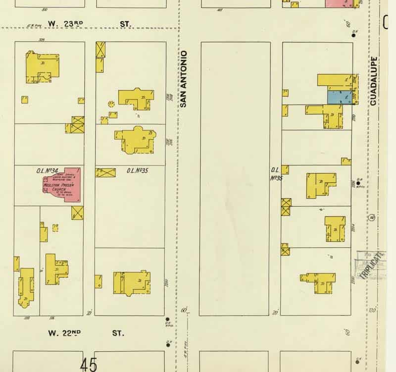

Kent McMillan, post: 381746, member: 3 wrote: Per the Austin City Directory, in 1891, Alfred Wyschetzki lived at 2106 Guadalupe Street
Wyschetzki's house would be the one shown in this 1900 Sanborn's map, the third one on Guadupe up from the corner of West 22nd.
One interesting detail about Wyschetzki may be that he was involved with the millions of acres of land granted to the International & Great Northern Rwy. Co. which were conveyed to the https://tshaonline.org/handbook/online/articles/ufn02&apos ;">New York and Texas Land Company and sold by them over decades. Another German-born Austinite, the surveyor Max Von Homeyer aka M.V. Homeyer, also worked for the New York and Texas Land Company in the early 20th century and made surveys for them all over Texas.

I'd say that Wyschetski's lot was North of the Texas Theater, where Hemphill's book store used to be.
