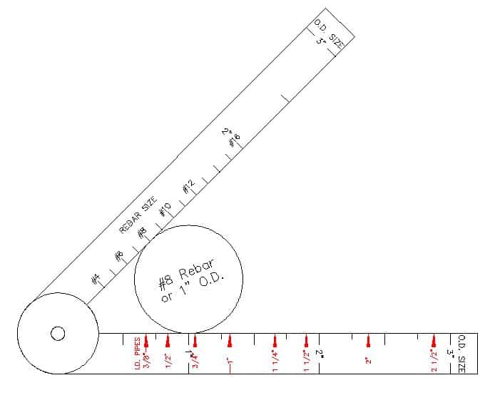

Here is the preliminary design. Not much bigger than a pocket knife.

rlshound, post: 331049, member: 6800 wrote: Have this hanging for ready reference....that tool should come in handy
Isn't the re-bar number simply the number of 1/8"s? Why wouldn't #5, aka. 3/5", be 5/8", like all the rest. Nearly the same size (.6" vs. .562").
