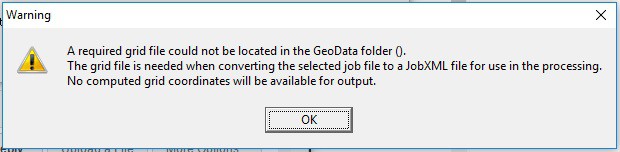

If you are trying to use the Trimble ASCII generator, there are a couple of other things you must do besides run the converter:
1 Download Trimble Access Installation Manger:
http://www.trimble.com/Survey/Trimble-Access-IS.aspx
2 Click TAIM, download, follow prompts. Then Update Windows office and your handset if neccessary.
3. Make sure that the geoid file (.ggf) you used to conduct the survey is present in the correct folder on your PC.
On our TSC3 it lived here:
My Device > Trimble Data > System Files >
Put it here on your computer:
C:Program Files (x86)Common FilesTrimbleGeoData
This worked for me, hopefully it helps others.

I am looking for help on this issue as well. Below is a run down of the programs I've installed, in the order I installed them.
1. ASCII File Generator (along with the FBK file custom style sheet)
2. Trimble Update Office Software
3. Trimble Link
4. Trimble Link Engine Install
5. Data Transfer Utility
After all of that, I still get an error message asking about a missing grid file (see image attached). I've followed up on this, and it refers me to download a .ggf file and place it on my local computer in the Geodata folder. Only problem is, I don't have a Geodata folder. Can someone help? Anything else I should be downloading?
Posted : June 9, 2016 8:58 am
christ-lambrecht
(@christ-lambrecht)
Posts: 1411
Hi Devon,
Your Geodata folder seems to be the problem.
That might be
or
C:Program FilesCommon FilesTrimbleGeoData
depending on your Windows and/or Trimble software installed.
A last possibility is to install the Trimble Co̦rdinate System Update
TrimbleCoordSystemUpdateSept2005 for TGO1.63
(see Trrimble.com) but i'm niot sure that will even run without TGO or TBC installed.
I'll add some other info as well from years ago.
Let us know if this helps,
Chr.
