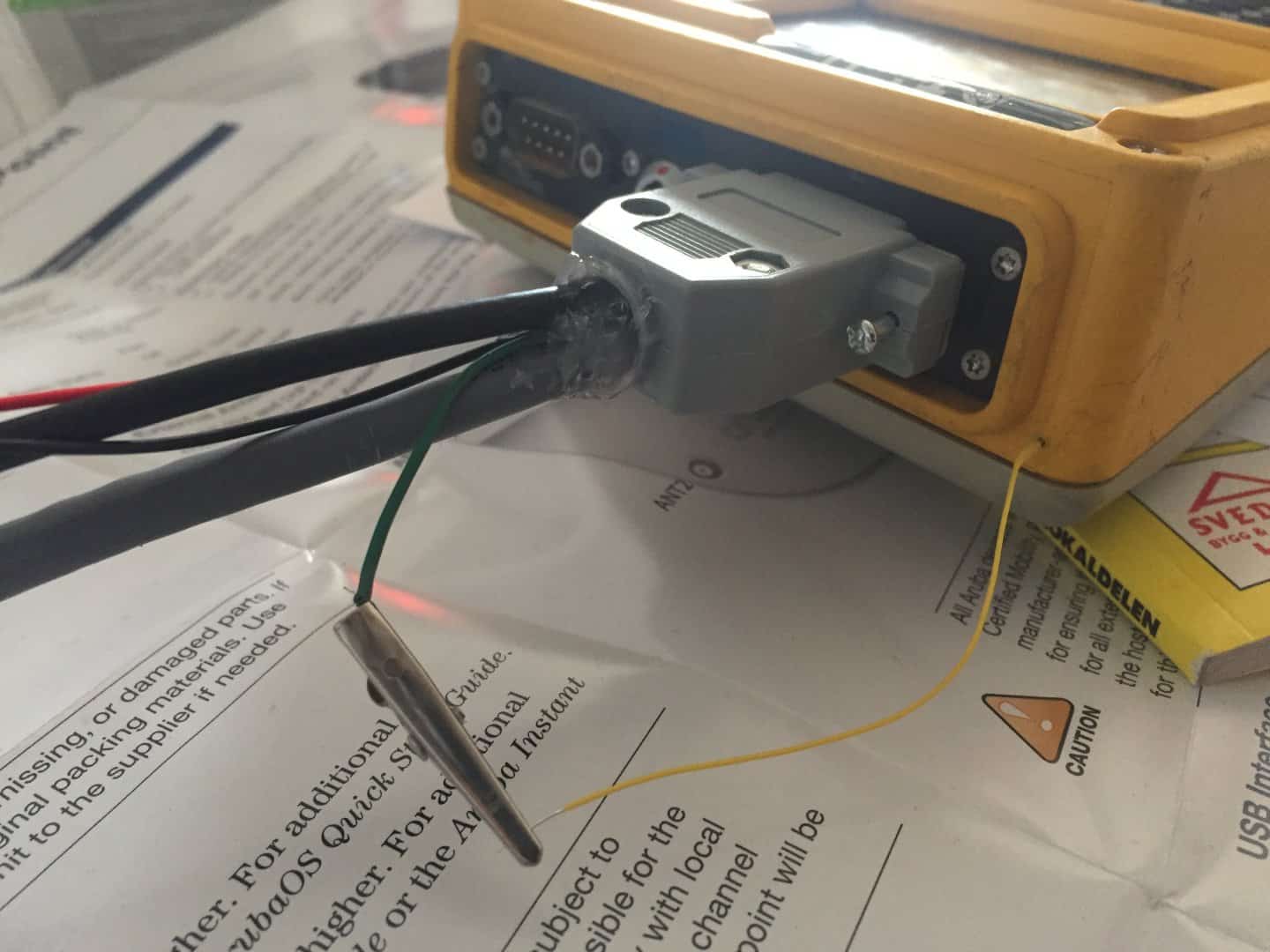

I have a TSCe where on pin in the multiport connector is broken (pin 9, one of the USB pins is missing).
Anyone has any idea how to get data out of the TSCe without USB?
I've tried using the serial port with activesync, but no connection.
I've connected ethernet but haven't found any way to get data out that way. I can connect to the WinCE FTP service, but I don't know the (default?) username/pass combo to log on there (it's supposed to be in the registry, but I cant find any way to look at the registry)
Any ideas?

The way I get at files on my TSCE is via the USB connector (on the TSCE's external multiconnector dongle) and Windows Mobile Device Center. It maps the TSCE as a drive. So if one of the pins that connects to the USB port is broken, then I'd be screwed like you may be.
If all else fails you can open up the case, pull out the CompactFlash card and use a USB based flash card adapter to connect it to your computer as an external drive.

I did however try to open the unit earlier, in hopes of finding a way to solder in a wire on the missing pin (on the inside of the connector), as a crude "fix" to get 'USB connectivity.
However, after removing all the visible screws (4 inside battery compartment + 4 more i think) there still seemed to be something holding the case together; i could not get it opened. Anyone who has opened a TSCe, that can tell if there are any hidden screws?

There is a screw in the middle of the narrow part of the body, accessed from the back. It is usually covered by a plug of clear RTV silicone - just run a sewing pin around the perimeter of the plug and it will slide right out.
Then you can turn out that screw.

I was able to open the TSCe and solder a thin wire to a SMD resistor that was connected to the broken pin. I drilled a 1mm hole in the case next to connectors and pulled the wire out through the hole. I then sealed it with silicone and put the TSCe back together.
I then connected half a lab cable (with a "crocodile clamp") to the USB+ line on the cable/connector that goes on the 26-pin multiport connector, which can be easily connected to the wire now sticking out of the TSCe. Now USB works, and windows mobile device center successfully connects!
Now that USB works I could also use "CERegEditor by mdSoft" to modify the HKEY_LOCAL_MACHINEcommFTPDAllowAnonymous and AllowAnonymousUpload registry keys to 1, so now I can also use ftp over the Ethernet connection to the TSCe built-in FTP server to get data out, as a second/backup option.
The TSCe lives again! 🙂
