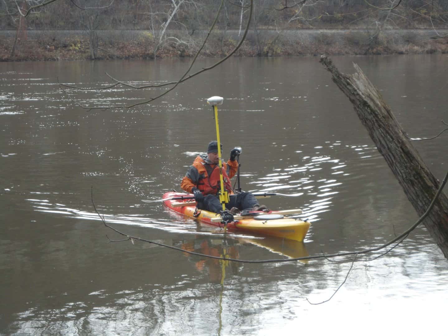

"I don' know what it be either, Huck. Might be some kinda fancy camra."

Dang it. I wanted to be first to make a comment about Tom and Huck out for a joyride.

It's been a long time since I read the novel, but my recollection is that Huck mostly shared the raft with Jim.

From this distance I can't tell if it's Tom or Jim. So I went with Tom.

Nah, don't think neither o' dem would wear no puffy orange jacket.
