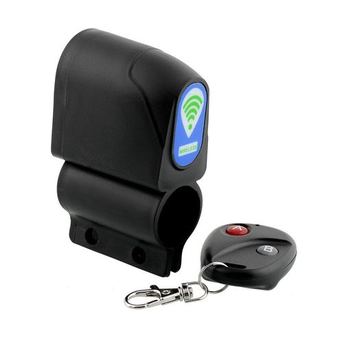

I just ordered a couple of http://www.ebay.com/itm/322245055086&apos ;">these:
Less than 5 bucks each shipped, so if they turn out to be junk I'm not out much. They seem to be like the ones Richard describes above, but with a remote.

Jim Frame, post: 415671, member: 10 wrote: I just ordered a couple of http://www.ebay.com/itm/322245055086&apos ;">these:
Jim, let me know how those work out. I like the looks of that!
Ordering now, thanks Jim.

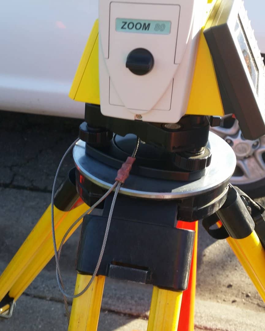

Nate The Surveyor, post: 415870, member: 291 wrote: and a hole through the bell housing, with a rod, through the hole, and locks on the rod, so you cannot detach the tribrach, from the tripod.
I came up with a number of ideas that involved locking the instrument attachment screw, but in the end concluded that all were more elaborate than yet no more effective than a cable threaded through the tribrach, so I went with the cable.
Posted : February 25, 2017 9:48 am
Jim, thanks.
I think you are right. Fast, simple, secure. Add to that the screaming bicycle alarm, and it's probably pretty good.
Anchor that to a trap anchor, or screw in anchor, and most would be thieves, are "in over their head", as the common modus operandi is "grab and dash" It's over in less than 30".
Posted : February 25, 2017 9:53 am
