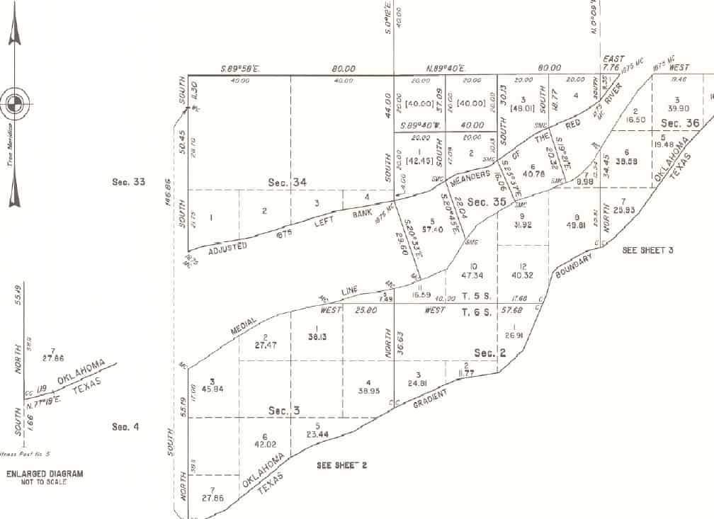

Interestingly, the surveyor that took 5 years to complete this survey (commenced 28Jul03 - completed 03Sept08) states in his notes that his retracement it was "clearly evident" the gradient line established by Arthur Stiles was found to have not changed since 1923. I say bullsh*t
A 2003-2008 Dependent Resurvey by the GLO in the area would affirm your assumption I think...maybe not.
FN_176845_Page_05150.pdf (1.1 MB)
Posted : February 2, 2017 8:38 pm
paden cash, post: 412187, member: 20 wrote: Interestingly, the surveyor that took 5 years to complete this survey (commenced 28Jul03 - completed 03Sept08) states in his notes that his retracement it was "clearly evident" the gradient line established by Arthur Stiles was found to have not changed since 1923. I say bullsh*t
What I get out of the field notes that you linked is an excerpt from the report of Arthur A. Stiles ca. 1925 in which he remarked that the gradient boundary in the vicinity of the Big Bend hadn't changed in two years.
The idea that a surveyor could put the gradient boundary as located by Stiles et al. in 1923 or so on the ground and consider that to remain the South bank of the Red River is upon its face more than a bit bizarre, however. For it to remain in the exact same position would require either (a) absolutely no processes of erosion or accretion present in that reach of the river (which seems impossible) or (b) that some avulsive event occured after Stiles survey in 1923 that cut a new channel but did not move the boundary as it had existed in 1923.
That last is possible, I suppose. I wonder if that is why the surveyor resorted to reconstructing the South bank from Stiles' work in 1923 or so. There was an extensive amount of investigation directed toward the question of where the channel of the Red River had been in the vicinity of the Big Bend in 1821 in the course of Oklahoma v. Texas - geological, hydrological, and botanical - and the conclusion was that the channel had gradually shifted after 1821 to the position it occupied in 1923 (or so).
Posted : February 2, 2017 9:19 pm

Just out of curiosity, I thought I'd pull the quad sheet and aerial photos covering the GLO plat that you posted. Is that in Tillman County, OK, just a couple of miles west of the Cotton County line, land appearing on Burburnett quadrangle?
Posted : February 2, 2017 10:03 pm
It's north of Wichita Falls, just east of the interstate.
Posted : February 2, 2017 10:04 pm
