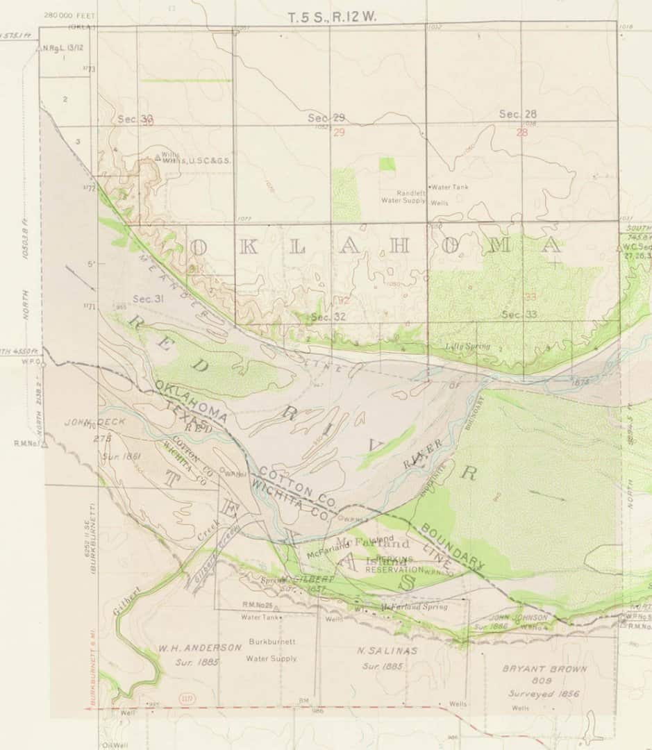

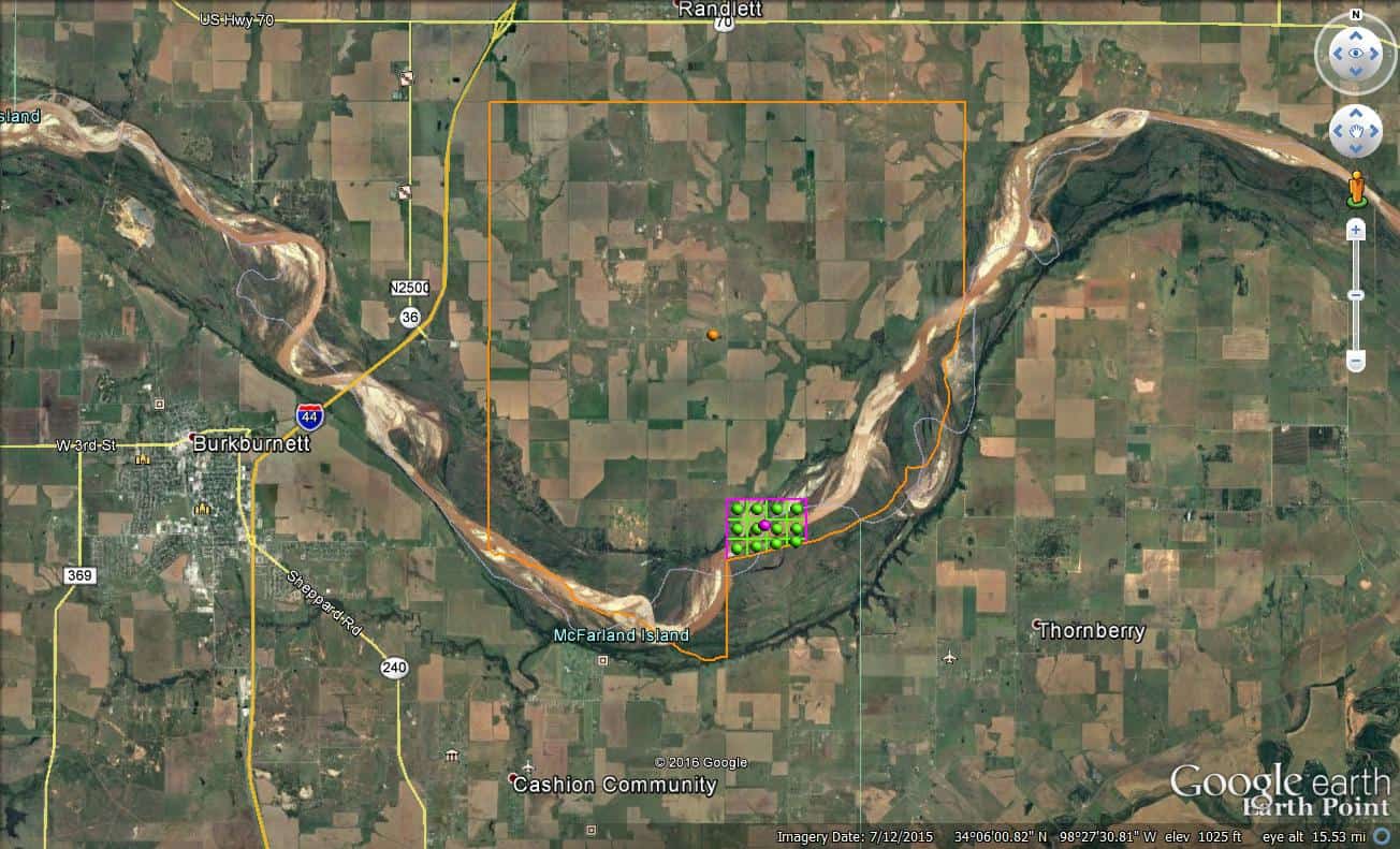

Kent McMillan, post: 412202, member: 3 wrote: Just out of curiosity, I thought I'd pull the quad sheet and aerial photos covering the GLO plat that you posted. Is that in Tillman County, OK, just a couple of miles west of the Cotton County line, land appearing on Burburnett quadrangle?
Twp. 5 South, Range 12 West, Cotton County...'bout 8 miles due east of Burkburnett.
Posted : February 2, 2017 10:14 pm

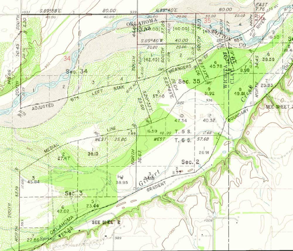

Okay, so here is approximately how the resurvey plat from which you posted a detail overlays Thornberry Quadrangle. The mistfit of the gradient boundary to the bluff line on the South bank doesn't appear to be consistent with an avulsion, so it does tend to make one wonder what evidence was thought to compel the conclusion that the 1923 gradient boundary location hadn't changed in 80 years.
Posted : February 2, 2017 10:50 pm
This reach of the Red River near Burkburnett should be one that was mapped by Arthur Stiles and his staff. So the topography of the river channel ca. 1923 would not be a likely subject for speculation. What is now Gilbert Creek could be a relict channel of the river. I wonder what historical aerial imagery exists for this locality.
Posted : February 2, 2017 10:56 pm

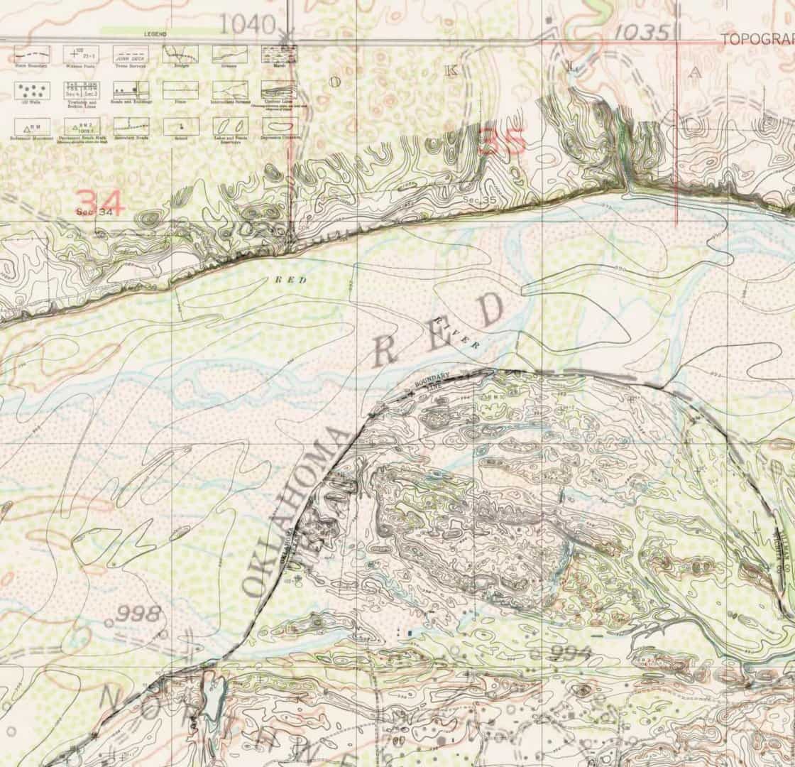

I took a part of the Kidder/Stiles topo map of a part of the Big Bend of the Red River near Burkburnett that I linked above and overlaid it on Burkburnett Quadrangle. As may be seen, the delineation of the Texas-Oklahoma boundary as represented on the quad sheet is essentially identical to that delineated on the Kidder/Stiles map.
Posted : February 2, 2017 11:54 pm

Here's what Map No. 6 from Kidder and Stiles' Third Report (linked above) looks like when overlaid on Thornberry, Tex quadrangle. Basically, it shows what appears to be the Kidder-Stiles location of the gradient boundary in about the same position as represented at the upstream end of the GLO resurvey plat.
Posted : February 3, 2017 9:19 am

One of the features shown on the USGS map is that Gilbert Creek runs approximately parallel with the river, but in a back drain that is probably formed by accretions between the creek and the river. That would make me think that the gradient boundary is probably on the river side of the accretions. It would not make me think that the gradient boundary hadn't moved a whit since 1923 along that reach of the Red, however.
Posted : February 3, 2017 1:30 pm

I don't know, but I'm going to go out on a limb and guess that the gradient boundary along the South bank of the Red River really is quite a ways from the river's North bank and is thousands of feet South of the Texas-Oklahoma boundar delineated by some USGS maps.
The vicinity of McFarland Island covered by the map below that is an overlay of the 1923 Kidder-Stiles map of the Texas-Oklahoma boundary onto the USGS Thornberry, Tex Quadrangle shows the gigantic difference between the State boundary delineated on the quad sheet and labelled "Indefinite Boundary" and where the 1923 surveyors found the gradient boundary to be. This is immediately upstream from the area shown on the BLM plat that paden cash posted.
At the time Kidder and Stiles did their mapping, Gilbert Creek flowed right into the Red River, but by the time of the arial photography from which the quad sheet was compiled, the creek had returned to flowing along a channel formed between the bluff on the Texas side and an accretion bank between the bluff and the main channel of the Red River.
The delineation of the State boundary on the USGS map looks more obviously wrong than the BLM location of the gradient boundary which probably is much closer to the Texas bluff than as depicted on the quad sheet. My somewhat educated guess is that if the gradient boundary is indeed held to be the South boundary of the bed of the Red River owned by the United States, that a whole bunch of landowners on the Texas side are going to have to deal with the fact that they never owned any of the land North of the gradeient boundary.
Posted : February 4, 2017 8:07 am
