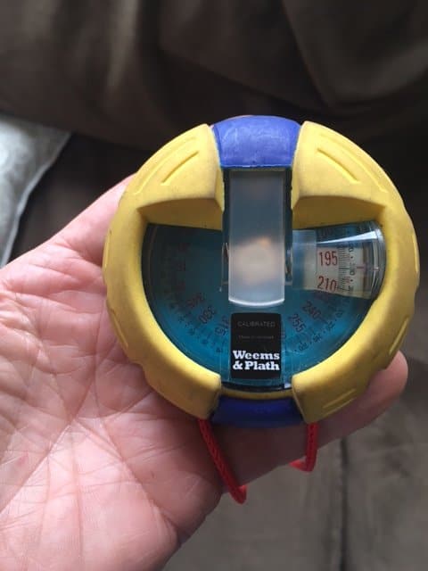

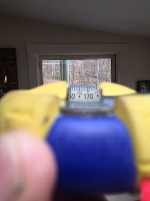

Regarding a tool to look into using, check out one of the several Marine hand bearing compasses such as this one made by Weems and Plath:
It may not be accurate to a minute, but the precision you gain by holding it up and sighting a line of flagging behind and ahead counts for a lot.
Also, because the compass "card" in these types of compasses is so low mass, local attraction rarely affects them unless you're standing over an engine block or something. They're very stable to use. The cards are viscously damped, for fast and easy use. I've never staked out logging tracts but trekked 10's of miles through dense woods mountain biking with one of these.
