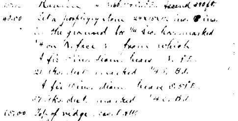

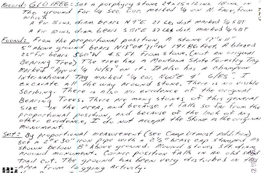

MightyMoe, post: 371887, member: 700 wrote: record was a mound of stone and set stone?
stone and 2 BT's- no mention of a mound....
From the CCR.....

There you go, more of those Montana scanned notes..........
And you know what, a couple of years of practice and I can read them now, lol
24x15x12, 18in in the ground, two trees.
Missed the LOOSE marked stone by just a few feet, he probably looked at that stone and couldn't see the marks, now you need to decide if it was already disturbed and the prorate is the correct location anyway,,,,,,,,, no mention of a mound and he is saying the BT's are gone? logged out?.
What's with the stone and trees 200' north?

well- all the timber cruiser tags are now attached to small trees around this location- not sure who moved them- there's one new cruiser tag in the vic also dated 2007. The 22" fir is still in place to the north - the blaze is fully healed and the remnants of nails remain where the locate tags were . There is a small mound of stone there, too. I'm not sure if this stone was moved from that location or just rounded up in the area here. Lots and lots of questions.
This is just one piece of this particular problem.
In 1995, a surveyor set out to  break out the SE1/4SW1/4 of section 5. He ends up setting the NW and SW section corners by double prop and the w1/4 of 5 by single prop and the N1/4 of 6 by single prop. and then breaks down the section for his 40.
In 1998, another firm is surveying lines all around sect. 5 for a state agency, and doesn't show any info regarding section 5 or the north line of 6.</p><p>In2005 another firm retraces 5 and accepts the mons set in 1995, and breaks down the section and sets the 1/16th corners for the north and west tiers of aliquot 40's.
My Job is to retrace the parcel whose north and west boundaries are the 2005 corners. I pull the surveys and see all this proportioning - that 4 stones and 12 trees at that they can't find any evidence of..... you've seen what I found at the N1/4 of 6. At the NW of 5 I found the same thing, the marked stone was lying on the east side of the mound of stone around the Brass cap... most of the bearing trees were ponderosa and the remains of those now are rotten mounds that can barely be identified as to species... once the stone gets moved either it is nearly impossible to Id the tree locations........
As for the stones being moved to the corners, I'd like to attribute it to ignorance on the part of the crews building the mounds or something.... I'd rather not like considering the option that they were knowingly moved.....

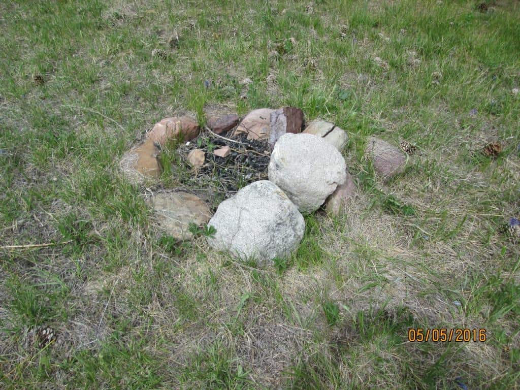

As far as the NE of 32, that corner was replaced by a crew by double proportion.... I found the stone in a campfire ring about 40 feet from the corner position they established
