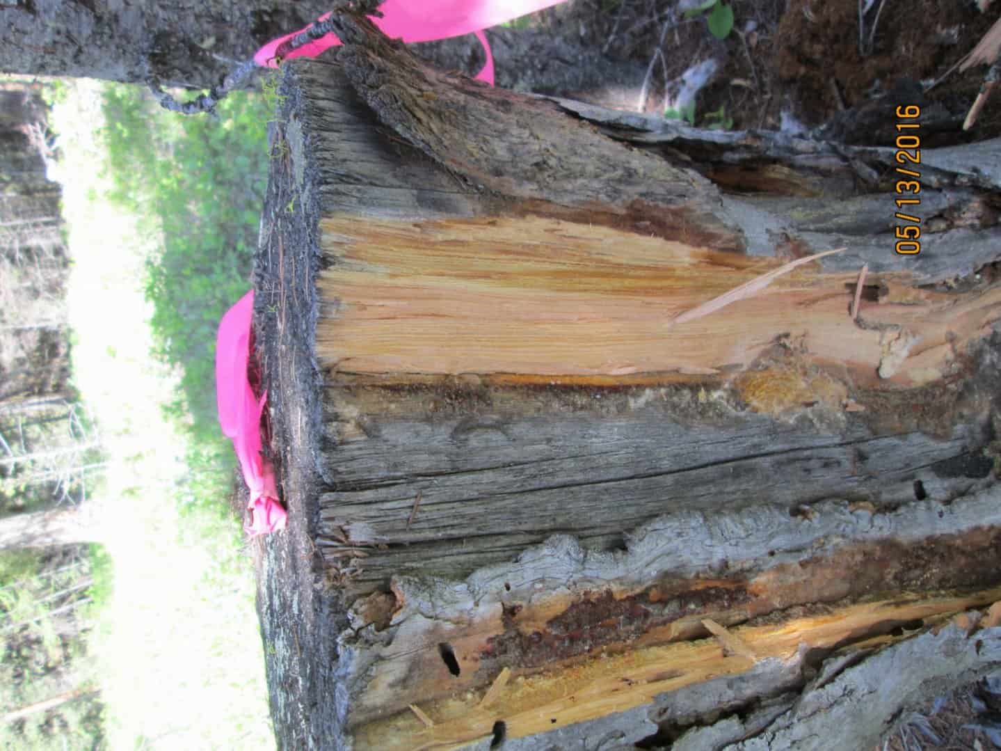

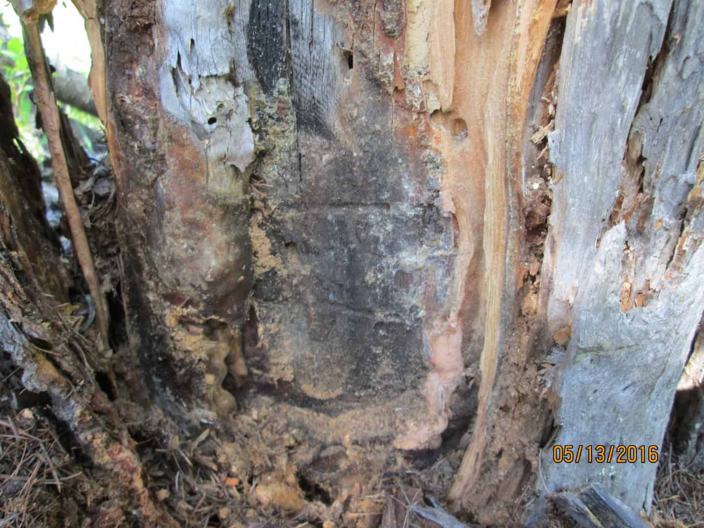

here are the pics of the NE BT......here's the bottom "BT" (sideways from the right)
Here's the top- hopefully it comes in orients correctly... the should be the to of "32"....
The location for the stone that was moved -+/- 2 feet- has a hole about the right size.
the location for the NW BT is near a stumophole and a shatter old fir stump.
corner based on the BT to the Brass capp set by double proportion is....
Inverse C113 to 132 N 85å¡ 26' 32.09" E Distance 13.9300
(NAD 83-11)
haven't finished looking for the SW and SE.- Like I said - I had to pop smoke early to get to town to pick up my son from daycare.
Now if you'll 'scuse me whilst I dance.... bop bop bop bop bopbopbop I'm alllll- right- no need to worry 'bout me....

I would pretend to be SURPISED that "someone" (presumably a "surveyor") would miss that Bearing Tree (and the other physical evidence that you describe), But I'm NOT!
Few years go by without seeing AT LEAST ONE "single/double proportioned, grant boundary'd, least-squared, mathimagically BS'ed MONUMENT from which OBVIOUS (and man I mean OBVIOUS) Original physical evidence of the ORIGNAL Corner Position/Monument or accessories thereof, stand out like a sheep turd in a bowl of milk!
Man I hate that kind of stuff!
:pissed:
