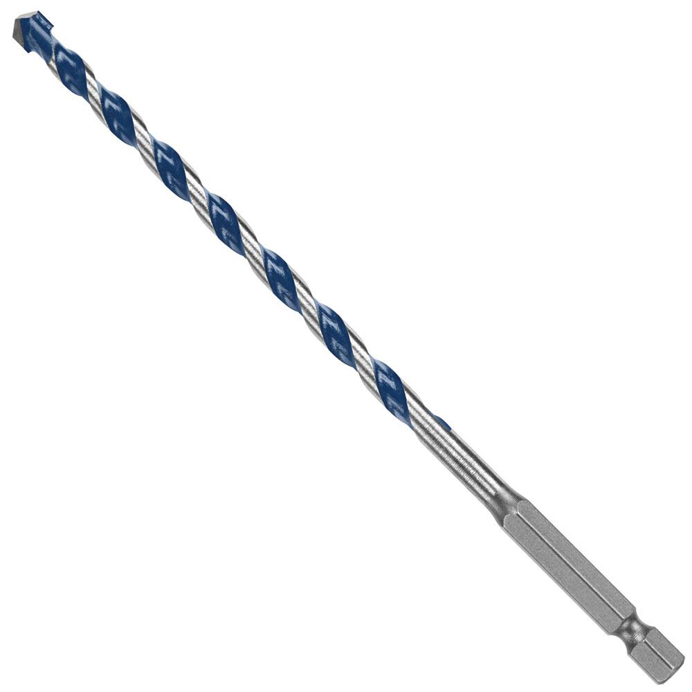

I have a Dewalt 20v XR hammer drill with a standard chuck.?ÿ I also have a corded 13amp Bosch combination hammer drill with a spline chuck. (yes, I tote around a small generator, but you can't beat the power of a corded drill!)?ÿ I'm ultimately wanting to?ÿset mag nails into rock.?ÿ A 1/4" bit?ÿwould likely do the job.?ÿ I've tried?ÿusing typical masonry bits from Home Depot, but they burn up and are useless within a minute.?ÿ Every time I search for a durable bit I find ones only with the SDS plus or max?ÿshank.?ÿ I also find bits for the larger spline chuck but the bit size is way to large.?ÿIs there an adapter for my dewalt so I can use SDS plus bits??ÿ Or is there a 1/4" bit with a spline shank out there somewhere??ÿ I know I'm not the only one out there wanting to set mags in rock, so how do you all do it?

I've used the Bosch BlueGranite Turbo bits in concrete and really like them.?ÿ I'm not sure how well they work in rock, but they go through the aggregate in the concrete just fine.?ÿ I also used a water bottle and drip water into the hole as I'm drilling it to provide some lubrication and cooling.?ÿ I use an 18.5 V Craftsman Drill, which isn't a hammer drill, but I've not had a problem.

After much research and gas driving around town looking for the correct chuck adapter, I eventually learned the adapter I was hoping to find doesn't exist. (going from a standard keyless 3 jaw chuck to a SDS plus bit) So, I bought the Bosch blue granite turbo bit and tried it on a boulder on the side of the road. Holy cow! That little thing actually works great! I think I drilled 2 holes in about 45 sec.?ÿThanks ARMeyer. And, the cost is negligible... about $15 for a pack of 5 (1/4in).?ÿI'm sure the SDS plus platform is much better, but for drilling 1/4" holes, a basic little dewalt?ÿhammer drill seems to handle the job just fine! ....for now ??ÿ

You're welcome!?ÿ I hated using standard masonry bits - they would burn up and the hole they left was too large.?ÿ I saw those in Home Depot one day and figured I'd try it out.?ÿ I couldn't believe it - it's like a wood bit for concrete!?ÿ Happy to pass the info on ??ÿ

I have found the Bosch bits to be way better than others, I have a Bosch battery powered SDS hammer drill and that combo make short work of setting 1/4" nails in pavement, rock, concrete, etc.. Without the hammer action turned on, slow progress, but a good bit with hammer action is almost too easy. I believe it is Lowe's carries the Bosch brand of bits?
