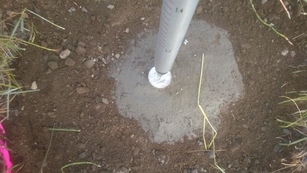

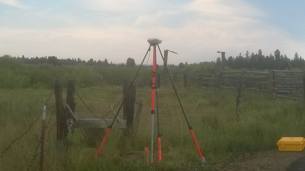

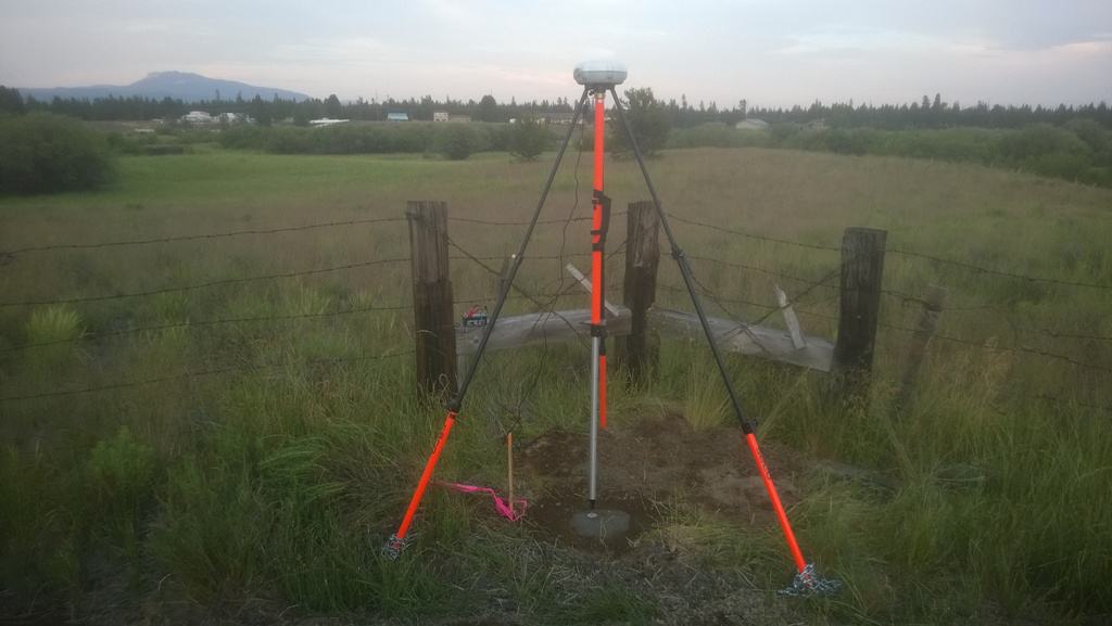

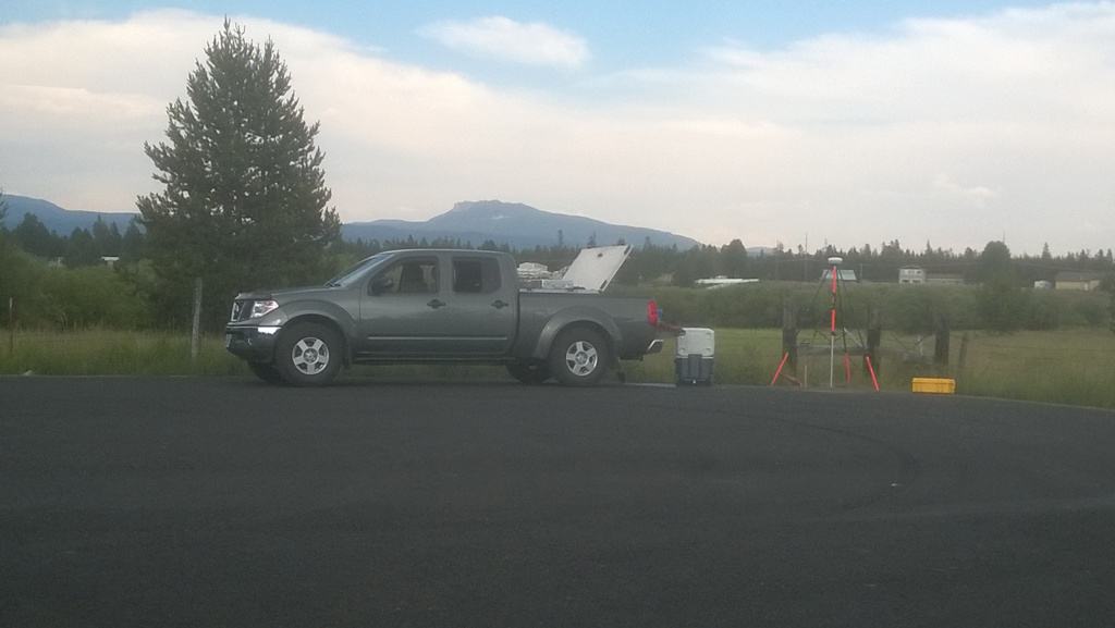

I just started my private Bench Mark network.
These photos are at the south end of Bridge Drive, Lazy River South subdivision near La Pine, Oregon.
Posted : July 2, 2015 8:28 am
OGBoundaryGuy
(@FRSH2O)
Posts: 329
Well I hope the Bench Marks that I set will have longer term stability than I will!
This is the first in my private network, set last week at the south end of Bridge Drive
in the Lazy River South subdivision near La Pine, Oregon.
