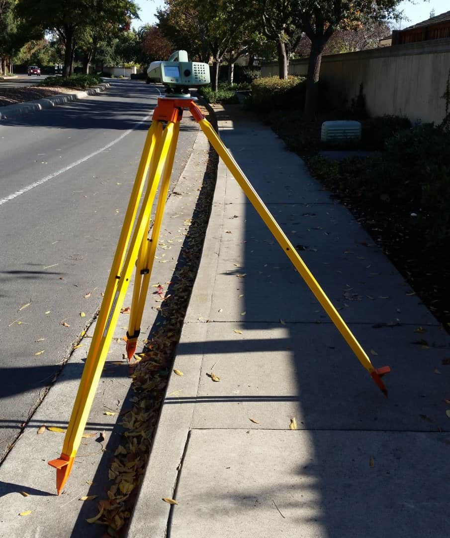

Yesterday I used the Nedo fixed-leg tripod I bought for leveling for the first time. This project didn't have to meet any published specifications, so I could have used an aluminum tripod, but it was a good shakedown opportunity. I learned a few things as a result:

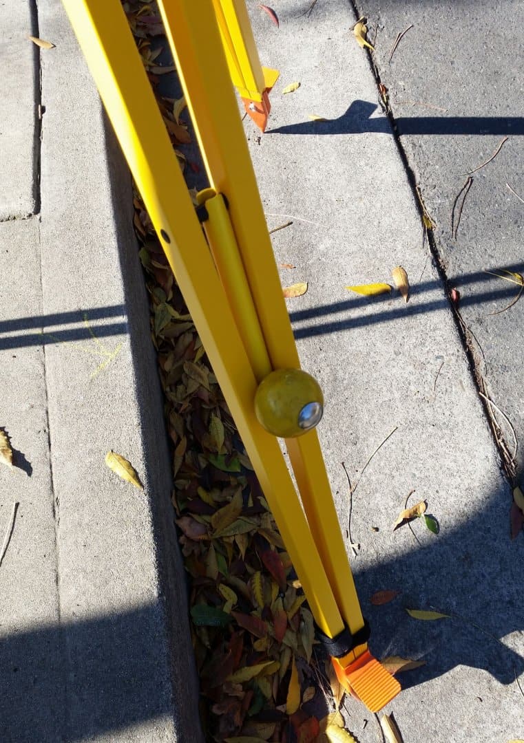

1. The tripod as equipped from the manufacturer doesn't provide any useful grips. Since a geodetic level should be carried as upright as is practical, balancing the tripod on your shoulder isn't a good plan. So I improvised with a hard rubber ball (I think it may be a lacrosse ball; I found it somewhere a few years ago), a 5/8" stainless carriage bolt, and a bit of 1/4" aluminum bar (visible in the upper photo). I drilled and tapped the aluminum to accept the bolt, then covered it with heat-shrink tubing so it won't scratch the legs. (The legs are wood, but they're covered with plastic of some sort.) There's a lot of friction between the bolt and the ball (drilling through rubber isn't what you'd call a precise operation), so I was able to tighten the bolt just by twisting the ball, and as it tightened the ball worked into the gap in the leg members. That held pretty well, but to be safe I added a piece of 1/2" PVC pipe (painted yellow) to the works. The bolt goes through one end of the pipe, and the other end is slotted to fit up against the tripod stabilizer bar. It worked pretty well, *but*:
2. This thing is heavy. I didn't weigh it, but I found that I can't comfortably carry it for long distances with just one hand. So I ended up supporting most of the weight with the ball hand, and some of the weight by just grabbing the legs with my other hand. It worked, though I think it made me walk a bit lopsided. We ran 3 loops for a round-trip total of about 3 miles, and by the end I was more than ready to put the tripod away. I wasn't sore this morning, though.
3. Whoever designed tripod legs with a rectangular cross-section must work in an office. When this thing closes on your fingers -- and despite my best efforts to avoid that, it happened many times during the morning -- those sharp corners hurt! A round (or rounded) design is much easier on the fingers.

What's the advantage of fixed legs? Weight? Is this thing for leveling only? It seems that if you were going to use it to set up over something, it'd be a pain to do so; i.e. to get the top reasonably level and reasonably centered. I must be missing something.

I take it rfc never surveyed with a transit and fixed leg tripod. The skill was in setting it over a fixed point and getting the plate as level as possible at the same time as getting it at a comfortable height.
No advantage to it except cost and sturdiness. What you are missing is good old experience.

Sounds like these tripod legs started as a good idea, then the cost-cutting came into the design.

The main advantage of fixed legs is just that, "fixed". There is no possibility that any adjustment coupling will come loose and have a leg "slide". Lighter weight may be a consequence of less parts but the main purpose is stability.

Jim from what I recall, the earliest tripod legs were square. We hve become spoiled with steady improvements.

This thing weighs about the same as my Trimax at 15 lbs. The Leica is almost 2 pounds lighter, but it's also about $200 more expensive.

I like the fixed leg for most leveling. Eliminates one source of error (mainly leg clamps getting loose). I did some precise leveling on a year long monitoring project and the fixed legs were specified. Highly recommend their use with a digital level, as Jim has in the pictures. And Paul, those were the good ole (or bad ole days)! Setting fixed legs up over a point, with a bob, on an incline, with a crew Cheif riding you to get moving! On top of that we always competed to see who could do it fastest and most accurately.

Jim is this NEDO tripod the only fixed leg tripod you have? Just wondering if you bought it to try it out.
How did your loops close?
If you need a fixed leg tripod with round legs (Wild) I can loan you one of mine anytime.

All closed well below 0.01 foot, mostly around 0.002 foot. We weren't using a turtle or pin, just kiel marks on pavement, so it wasn't intended to be a geodetic-quality run. But the Nedo, while heavy, seems okay to me.

Jim, is that a DNA03? What kind of leveling do you do to justify the cost?

Every few years I get a job that requires some Second Order Class II leveling, so I bought the DNA03 and a 2-meter invar barcode rod. There aren't many firms around here equipped for geodetic leveling, so while the opportunities aren't frequent, they're lucrative.

The level weighs a bit over 6 pounds with a small battery; I had to look it up and was surprised, because it seems so much lighter. The Nedo tripod weighs 15 pounds; I had to look it up and was surprised, because it seems like it weighs a ton!
