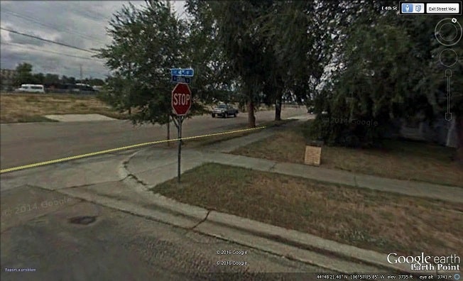

" Officially, the USGS lists the Sheridan Astro Station as ‰ÛÏpresumed destroyed.‰Û But the pillar at corner of Crook and Fourth streets in Sheridan stands proud.."
So much for a USGS "presumed destroyed" station:
Posted : July 6, 2016 8:20 am
Posts: 10674
The astro point was saved during a rather large SID project starting about 1994....
The area was marked by unpaved roads and it was to say the least messy, when the engineers and surveyors designed the sidewalks and underground upgrades they made sure to save the monument....
As an interesting aside that project covered an extensive area and because of that property lines needed to be located and were incorporated into the project using the city state plane system. So all the property lines were pretty accurately controlled based on a HARN point just east of the astro monument.
Those lines were inputted into the city GIS and when layered over the county wide photo made an accurate representation of the lines and the features on the ground. If you go onto the county GIS website today you will see that the property lines are shifted about 15-20 east southeast........now the property corner is shown almost on the astro point, when it was properly shown west of it's present location at the back of walk intersection,,,,,,,,what changed?
I don't know but I'm sure it was a surveyors fault:cool:
