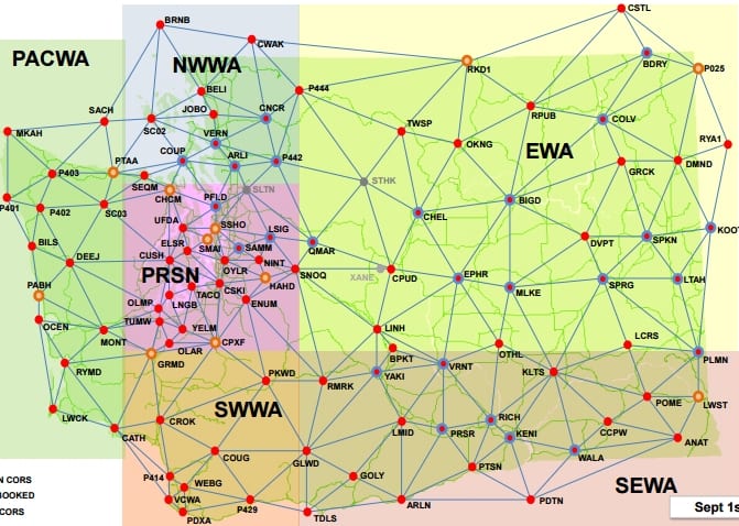

gschrock, post: 348946, member: 556 wrote: Hello Conrad,
Of course we would much rather never have to deal with velocity, but our state is on the edge of the plate, the Pacific Rim of Fire, and conflicts with the relatively tiny San Juan de Fuca plate which is wedged between our coastal regions and the Pacific Plate.
At plate edges, velocities vary more towards the edges, in both speed and direction. In the interior of our state the movement is more homogeneous (as you've described) and CORS (or local stations) may not go out of tolerance for 4-8 years. But on the coast that can be as little as 4 months for an individual station. The National Science Foundation funded the PBO (plate boundary obsertvatory) project that put 900 CORS, mainly on the west coast.
We learned the hard way. When our network began and was confined to a small area the movement was fairly homogeneous, but still over a few years we saw individual stations going out of tolerance faster than others that were only 70km away. Users in areas of predictable movement know to update any calibrations as CORS are updated. We had a lot to learn from areas of the world with massive geodetic arrays in tectonically active zones (Japan, Malaysia et al). The question was how best to maintain the 1x2 cm tolerance for the network while constraining to the national framework. The answer came from academia and the NGS.
Our first 2 stations were built in cooperation with the two universities in our state studying regional plate movement. They have had continuously operating GPS sites since the early 90's in a wide array - we have also collaborated on all of the 100+ stations in our network to these to their mix. A groundbreaking study of subduction zone quakes (aka silent quakes) is shown in thttp://www.earthscope.org/assets/uploads/events/Tim_Melbourne_Presentation.pdf&apos ;">he following link to a presentation w/ graphics showing the varied velocities around our state. You will see what we are up against.
The jointly developed solution (for the 110 stations of the several hundred in our state that are in real-time solutions) was to divide our state into six functional zones (see below), based mainly on the generalized velocity in each zone (and the predicted rate at which to update) but also we had found that the tropospheric scaling in the processing for real-time varied as from the coast or mixed regions and the far interior. This amalgam of considerations is why some folks had also found that mixing and matching baselines of varied lengths under rapidly changing conditions yielded inconsistent results.
Users of network solutions know which zone solution to pick when they work in different parts of the state, and how much the values may have changed since their last observations in the same area. Different users have different approaches to localizing for time dependent consideration or ties to legacy local control (as Moe has noted). That is up to them, we simply provide updated NAD values for the stations. Actually, we do the evaluation of the relative integrity of a subnet in ITRF as one of the steps bu publish in NAD. We constrain to NGS CORS each time we need to update, but we will choose which NGS CORS have current values that have not gone out of their own tolerance (sometimes they do not publish new values until the site is far out of tolerance as Jim noted in posted graph.
Yes, it would be wonderful to work in the calm interior, but I am truly appreciating the surveyors out this way who have learned (over 14+ year now) how to live on the edge.
Good morning Gavin,
Is HTDP enough to keep up with such a dynamic zone? Or, do you resort to other means to stay up to date with the changes?
Posted : December 14, 2015 5:44 am
