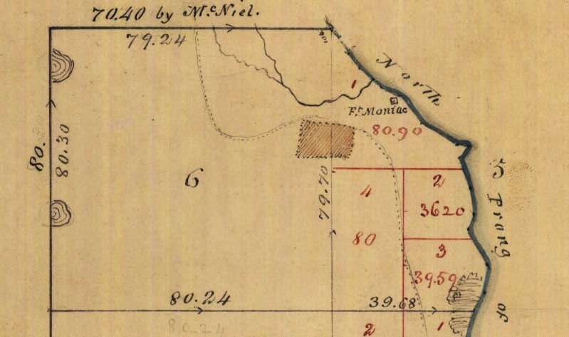

Does anyone know how features such as Forts that appear on Florida Township plats, the boundaries of which were surveyed in 1825 and section lines surveyed in 1849, were plotted. There is no information that I can find in the field notes referring to the location of this Fort. I have information indicating that the fort was dismantled in 1838 so would not have been existent when the section lines were run. The Fort in question is Fort Moniac near the source of the St. Mary's river from the Second Seminole Indian War and I have determined that I had an ancestor 2nd Lt Cornelius Rain who was stationed there in April of 1840. I currently live about 7 miles South of the location shown on the township plat and am getting permission to "hunt" the private land where it appears for artifacts with a metal detector and am curious how accurately those things were plotted on the plats.

There are a number of Forts that existed in Oklahoma at the time of the GLO surveys. Most of these were after 1870 however. Most are not particularly detailed but fairly accurate in their location. These forts were where the survey crews received shipments of equipment, viddles and their pay. I would bet they located them.

I'm not at all familiar with the Florida surveys, but they are probably your best bet. Where else are you going to find a map or plat that early with any precision?

This brings up another question. How or where can I find the original field notes from the survey? The notes available appear to be hand written transcripts of the originals as they have no accompanying sketches whatsoever, this old fort lies on the bank of the St Marys river and would most likely have been located during the meander of same which took place during the 1849 survey of the section lines. The notes available for the running of that line make no mention of the fort.

I'Ve been told that items of topography not tied in directly in the survey are sketched in by the deputy from memory with their locatiOn determined "by ocular estimation"... A sketch plat was prepared by the surveyor and transmitted to the survey office along with the draft notes.

Jerry will have the definitive answer, but the original field tablets were almost always destroyed upon completion of the field notes and plat.
