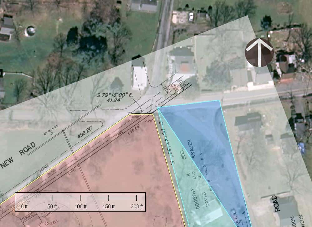

Not really. If the landowner were my client, I'd suggest doing a bit of field investigation to confirm that if the subdivision boundary were adopted as the common boundary that his ownership would actually be enlarged, and then see whether the adjoining landowner would like to enter into a boundary agreement to "settle" the dispute.
I know within a few feet where I'd look for the planted stone at the POB of the aqua-blue triangle and I know where I'd spend an hour with a probe and expect to find the original SW corner of that same tract, but until those come to light, this is all just educated guesswork.

Let's not lose sight of the fact that the subdivision plat under which the adjoining landowner evidently claims certain boundaries is hardly any marvel of science. Can you see, for example, what might POSSIBLY be wrong with this plat?
Posted : September 3, 2017 9:38 pm
Kent McMillan, post: 444939, member: 3 wrote: Let's not lose sight of the fact that the subdivision plat under which the adjoining landowner evidently claims certain boundaries is hardly any marvel of science. Can you see, for example, what might POSSIBLY be wrong with this plat?

That engineering plan style of subdivision map is what you get when engineers and planners run the show. Topo? Check! Soils map? Check! Utility Poles shown? Check! Oh, what about the evidence that the boundary was based upon? We'd like to show that, but the plat is pretty much covered with engineering data already.
The marvel about that particular plat is that BOTH roads bounding the subdivision are misidentified on it. Schoolhouse Road that is on the West side of the tract subdivided is shown as being on the East side of it, for example, and what is actually known as Schoolhouse Road is indicated as being a certain State Highway, which I believe is another road entirely.

Actually, what that sketch shows is that if a surveyor really wanted to find the stone that marks the South corner of the turquoise-shaded triangle, he'd probe an area about 7.5 ft. SE of where the corner is indicated on the subdivision plat. That looks to me to be the easiest of the four stones to find and, having found it, the rest which fall in roadways should also be locatable.

The 1982 Plat shows Schoolhouse Road being the road that passes the schoolhouse. the area map shows Hill Camp Road as extending North from the intersection. At about that time county planning agencies tried to eliminate roads having multiple names to make the 911 address street address system more rational. One reason I know that was, I was on the advisory board to the Lehigh-Northampton County Planning Commission around 1970. It makes sense that the name Hill Camp Road was chosen for the continuation to the South from Harmonyville. That New Road was most likely a dirt lane that then became a part of the state Highway system. In fact it also may have been referred to as Schoolhouse Road, and was thus so named after that.
As an aside I was born and raised on Kesslersvile Road in Stockertown, PA. From Stockertown the road went East to Kesslersville, and at the end of it was the one room Kessler School House, where both my father and mother attended. That corner was the intersection of Kesslerville Road, Stockertown and Kesslersville Road, Forks Township. Around that time an industrial park was built on Kesslersville Road in Forks Township and truck traffic tried to access it by driving up Kesslersville Road, Stockertown, over a weight restricted bridge and stop at the first house, ours, for directions. My father a Borought Councilman at that time got tired of it and dreaded the day that a heavy truck put Kesslerville Road into the Little Bushkill Creek. Having done ancient deed research in our area, he proposed that Kesslersville Road, Stockertown be renamed Lefevre Road after an early patent holder.
I do find it unusual that the ultimate right of ways in that area are 45' width, per that 1982 plat.
If you are inclined to get the highway maps for L.R. 15131, contact the PennDOT District 6 archivist.

The plat of PARCEL 19-3 WARWICK TOWNSHIP that an engineer prepared in 1991 shows what is now apparently known as S Hill Camp Road as Hill Camp Road, so what you're saying is that S Hill Camp Road had been known as Schoolhouse Road probably got renamed as Hill Camp Road sometime between 1981 and 1991, and the unused name, Schoolhouse Road, got applied to another road? I wonder if they were able to reuse the road signs for maximum Quaker economy. :>

Kent McMillan, post: 444978, member: 3 wrote: Actually, what that sketch shows is that if a surveyor really wanted to find the stone that marks the South corner of the turquoise-shaded triangle, he'd probe an area about 7.5 ft. SE of where the corner is indicated on the subdivision plat. That looks to me to be the easiest of the four stones to find and, having found it, the rest which fall in roadways should also be locatable.
Kent,
Good luck with that. I have never ever even thought to look under a road that has been paved since W.P.A. to look for a stone called for 200 years before that. I have found RR spikes and pipes, but I had sufficient noise from my Schoenstadt to know it was worthwhile. The real joy is having a sound 2' from the current centerline and to begin removing asphalt to find much older yellow paint exactly over the older iron. A stone not in a road is much more likely to have been buried within a 10' wide by 3' high stone/tree row, many of which have been cleaned out to make larger uninterrupted fields.
