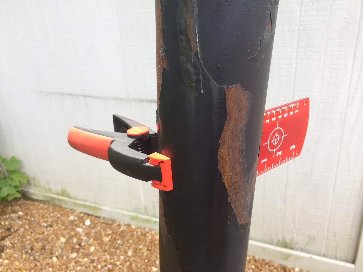

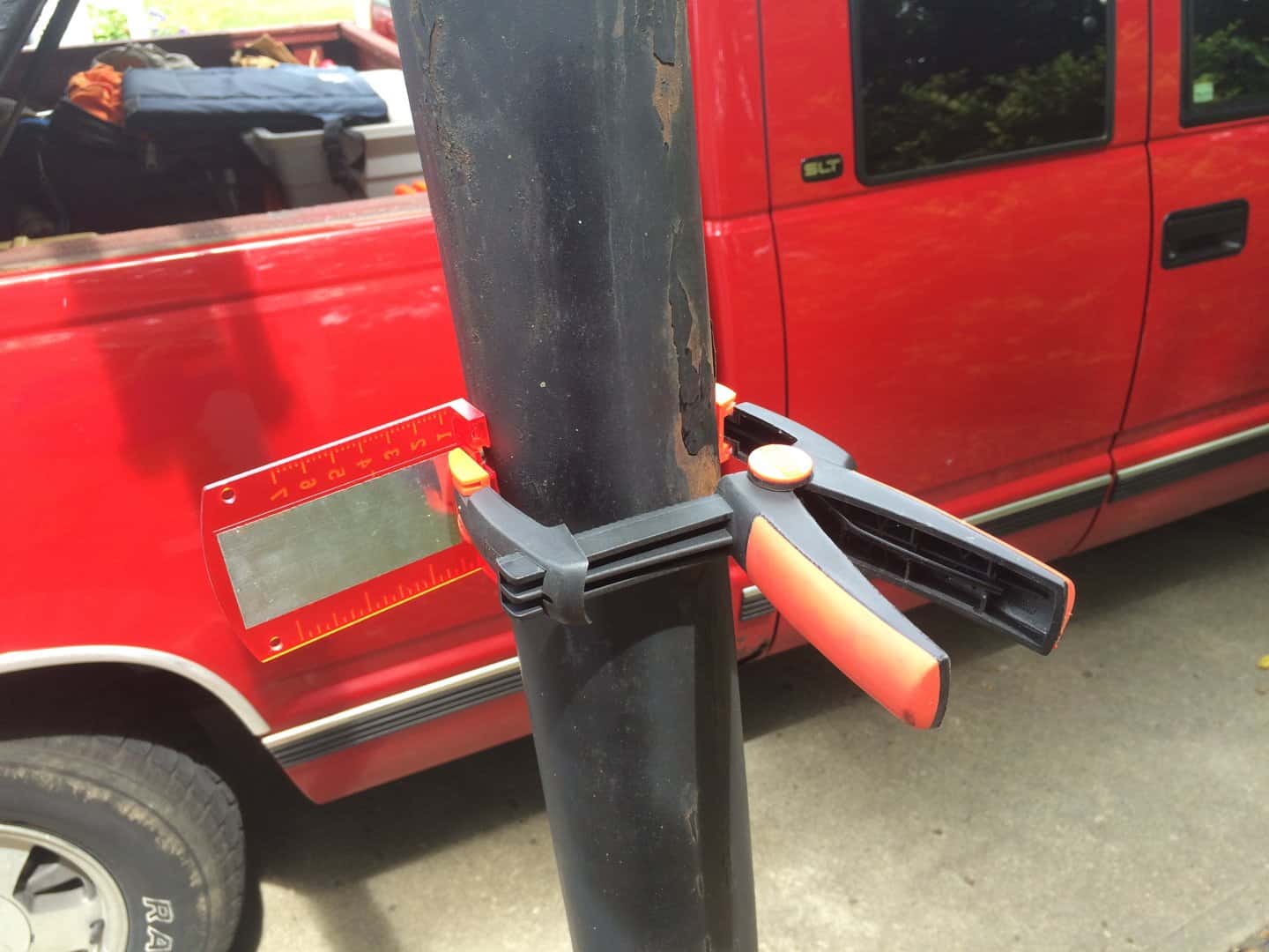

Irwin frame clamp and a square of cardboard or Masking tape and a square of cardboard on some building corners

I have not found anything that can be used repeatedly to attach to the corner of a building to obtain that lazer shot to the outside corner.
A roll of masking tape and a cardboard target has helped most of the time.
I have attached the cardboard to the end of a piece of PVC and leaned against building corner.
To extend the disto out from a building I've used a lath held against a side of the building
The frame clamp works good on most brick and other corners with a capped edge.

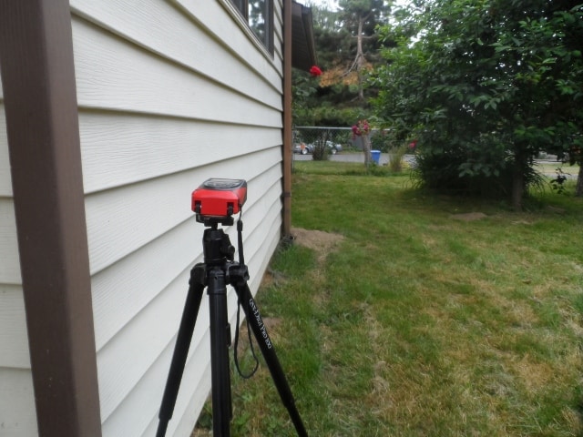

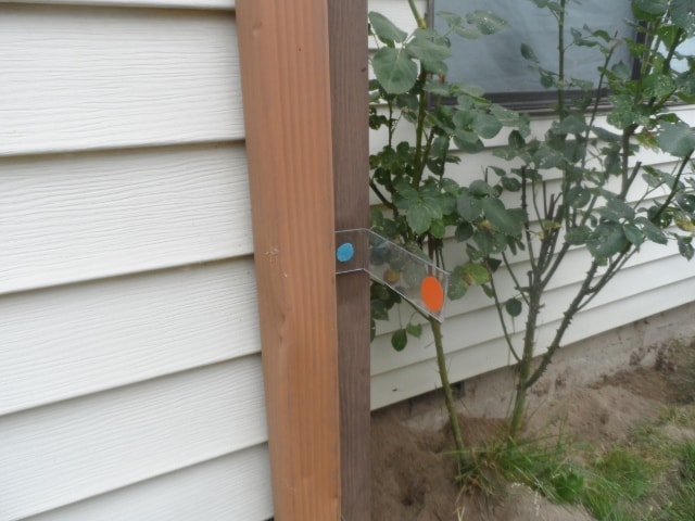

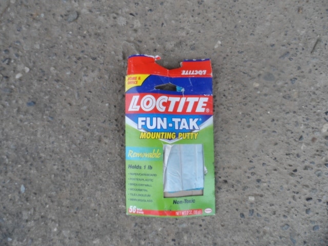

I know exactly what you're talking about, Steve...
I know a guy that works in a machine shop, he made some prototype "L" brackets for me. They are long enough to stick out from behind a downspout:
I stick it to the surface with fun tack. You need a clean surface, if you want it to stay very long and this stuff lasts for ever:
I have my disto mounted to a camera tripod; it helps keep me steady and I don't have to keep pulling it out of my pocket:
My son in law works at a company that makes parking lot gates; he gives me all the orange and silver reflective tape I want. My buddy at the machine shop sharpened a 1" pipe for me; I use a rubber mallet and a piece of plastic to cut out 1" reflective discs.
Is this what you were talking about?

Brother, that's what I'm looking for, now I have a few ideas to work with. I've never heard of that "putty" so now I am going to have to look for it.
Thank you.

Just A. Surveyor, post: 436320, member: 12855 wrote: now I have a few ideas to work with.
The camera tripod will be under 30 bucks, the fun tak is a couple bucks at Walmart; the whole set-up is pretty cheap. I can go around an upper middle class home in about 15 minutes. I also use a 30' pocket tape field book. The disto set-up works great on those 50 foot distances. I also have a lath, if there is a lot of crap in the way.
