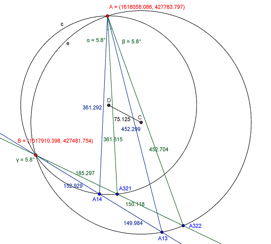

rfc, post: 328748, member: 8882 wrote: But, if one wanted to estimate (or calculate as closely as possible), where the center of the circle would be, such that if one of the lines was rotated on an arc of that center point, the two would align very closely?
A fascinating problem you have posed, sir. Indeed, you can rotate one of the lines so that it aligns exactly with the other. And, one of the two pivot points can be found easily with algebra.
Here's the diagram:
Note that one of the pivot points is the intersection point of the two lines. The other is the intersection of two circles. The first circle is the one that passes through points 14, 321, and the intersection of the two lines. The second one is the circle that passes through points 13, 322, and the intersection of the two lines. When you do this rotation, the two lines will coincide exactly and the error will disappear. If you visualize the two circles as the ends of a telescope, the points are misaligned only because you are looking through the telescope at an angle. When you square your view, the points coincide.
Points C and D are the centers of the two circles. They are just more than 75 feet apart. The angles between all of the significant pairs of lines emanating from the vanishing points are 5.8 degrees, which is the angle of rotation required to bring the lines into coincidence. Probably not the best way to handle blunders, but it is an interesting problem.
Posted : July 26, 2015 3:40 pm

Your two pivot points will make the lines co-linear, but only pivot A will make their endpoints near coincident, which I understood was the goal.
Furthermore, the lines 13-14 and 321-322 as given were not of identical length, only close. Therefore the optimum pivot point to minimize the difference in endpoints cannot be found exactly by this construction. And the perpendicular bisectors of the lines 13-322 and 14-321, using the method shown much earlier in this thread, do not intersect at exactly either Point A nor the optimum pivot.
Posted : July 26, 2015 4:03 pm

Bill93, post: 329173, member: 87 wrote: the lines 13-14 and 321-322 as given were not of identical length, only close
It's hard to put one over on you, Bill. While it's true that, if points 321 and 322 move along their respective circles, they will coincide exactly with points 14 and 13, that would not be a rotation. A rotation keeps distances constant. Thanks for pointing that out and setting me straight. Your pivot point and mine are close to each other only because the two lines are almost the same length.

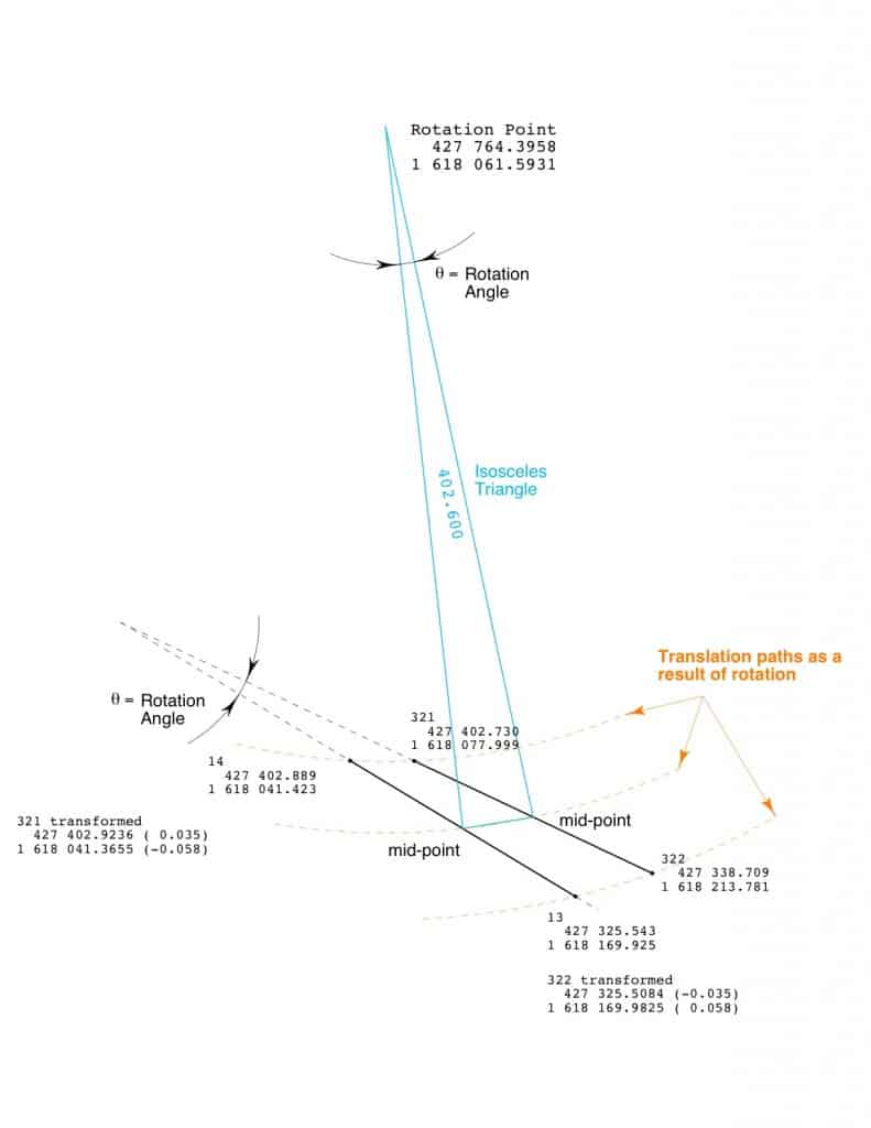

Before getting into any other discussions about the problem presented in the original post:
There are two significant conditions affecting the desired solution.
1. The measurement precision is the same for all the points given.
This means all points have the same weight.
2. The measurement units for the position of both lines is the same.
This means the scale is unity.
Because there are only two points, only two measurements for each and that precisions are the same, it means the residuals for or at the transformed point locations will be equal. Excluding the probability the measurements between the one set of measurements and the other are exactly the same, because scale is unity, the values of the residuals will not be zero.
An item I believe is being overlooked is that in a rotation, it is completely irrelevant where the rotation point is located. To comply with mathematical convention, I use the term rotation point instead of pivot point.
In the solution by MathTeacher, it is stated "Note that one of the pivot points is the intersection point of the two lines. The other is the intersection of two circles." This is all well and good. However, any point in the plane can be used to rotate about. Regardless of the rotation point location, it is the rotation amount determined by the difference in two line directions that aligns one line with another - that is - makes them parallel. By making the lines parallel, the residuals, associated only with the rotation, are minimized. For two parallel lines in a plane the minimized distance between the two lines is produced by the shortest line which is the length of a line normal to the two parallel lines.
To illustrate this, whether one uses pen and paper or a computer drafting program, one only has to draw two lines, one at a different direction than the other. Rotate one of the lines about any point by the difference in directions to make it parallel to the other. This shows that no matter what rotation point is used, if the lines are parallel, they are aligned along the same direction. It further illustrates the basic geometric theorem and its converse are true:
Parallel lines have the same direction and Two lines of the same direction are parallel.
Because of the conditions stated, the translation has to be from the mid-point of the rotated line to the mid-point of the other. If this is not the case, then the residuals will not be equal. As in the rotation case, this may be visualized by drawing on paper or the computer screen.
Using popsicle sticks, it is possible to physically reproduce the problem and solution. First, one stick is cut by a small amount and rounded. Then, both stick ends are labeled with 14 and 13 on one and 321 and 322 on the other and mid-points are marked on each. Next the sticks are laid down on a table in an orientation approximating that in the problem presented in the original post. After this, the stick labeled 321 and 322 is rotated, using any rotation point, to be parallel with the stick labeled 14 an 13. Keeping the the stick labeled 321 and 322 in its rotated orientation slide, transpose, it to the stick labeled 14 and 13. This completes a physical representation of a least squares transformation of rotation and translation for two points. It is that simple and not any more complicated than that. Just why would anyone want to complicate such a simple solution? Why?
While solutions so far presented may be to determine some other desired objective, they circumvent the simplicity of the geometry of the originally desired solution. It is possible to fly from Los Angeles to Seattle by flying from Los Angeles to Mexico City then to Denver and finally to Seattle. However, simplicity is achieved by flying directly from Los Angeles to Seattle. If there are reasons to be in Mexico City and Denver, then that's what needs be done. If there are no reasons, why then fly to Mexico City and Denver?

Not to beat a dead horse but, any rotation of two or more points will at minimum result in a translation. If the rotation point is one of the point the others will be translated. If the rotation point is not one of the points then, all points will be translated. It is impossible to do a rotation of two or more points without it resulting in a translation. The points move, meaning in mathematic parlance, they are translated. In Euclidian geometry, the notion that the problem can be solved without a translation is impossible. The response "One answer is that the original problem prohibited the use of a translation" did not disclose or denounce this impossiblility!
It has been my argument that it is not necessary in the surveying situation presented to find a rotation point that results in the desired translation. It is a digression and distraction. In designing mechanical parts, and this was alluded to in the first post, it may be a consideration. However, determining this special "rotation point" is not necessary for achieving the final objective of transforming the two points so that the residuals are minimized - "the two would align very closely" - called a "best fit" by some. Its educational value is that one learns it is not efficient. Perhaps the extra time and effort is justified for the surveyor as a function of time-billable hours? How is it justified for a client?
However, if it is so desired, in order to find the intermediate desired objective rotation point, the following steps will yield the solution:
1. Determine the difference in direction between the two lines to determine the rotation angle.
2. Construct an isosceles triangle with the rotation angle opposite or subtending the line connecting the mid-points of the two lines.
3. The rotation point is the vertex of the angle opposite the base of the isosceles triangle.
Refer diagram
Am I befuddled? A surveyor wanting to learn has taken himself down a path that does not lead to an efficient solution. Should he be directed to continue travel on that path or might it be better to suggest a direct path?
As for detecting traverse or survey network problems, in most cases drawing and examining a complete scaled drawing will not only reveal them but, suggest the more efficient solutions. Combined with a least squares adjustment, it is even more effective.
