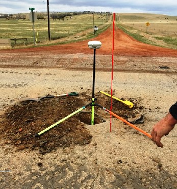

I encountered one quarter corner located near a railroad crossing in the middle of a graveled county road. Over time the road bed had been elevated, apparently more than once, to lessen the steepness of the approach to the crossing. Following the record surveys we learned that the original monument was a limestone of specific dimensions set in the government survey in 1865. Above that was a 1" axle approximately 24" in length set in the 1930's. Above that was a 5/8" iron bar approximately 24" in length set in the 1950's. We found the 5/8" iron bar a bit more than two feet deep per the references from the 1950's. We then set a 1/2" rebar 24" in length above that to make the future surveyors jobs considerably easier than what we had encountered.
