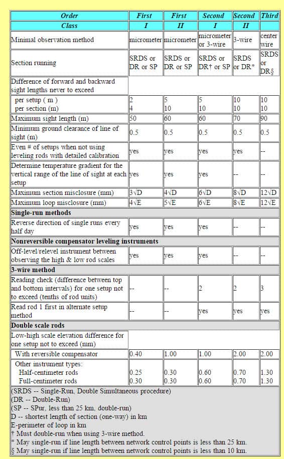

It is allowable in the NGS specs to run one way between existing marks if the new run meets the section misclosure. All new marks must be double run.
From "FGCS Bar Code Leveling Specifications V4.1:
For establishing a height of a new bench mark, double-run procedures must be used.
Single-run methods can be used to relevel existing work provided the new work
meets the allowable section misclosure.
In the days before digital levels, it was acceptable to do single runs when using a double scale rod and there were a sufficient number of existing marks at each end (2 mark and 3 mark ties). I did a 130 mile second order class I line in 1989 that we only had to run one area (about 50 km) double run where there were no existing marks. There were existing marks along most of the route (Pittsburgh to Fairmont, WV along the Monongahela River). FGCC specs stated that for second order class II, lines could be single run if it was less than 25 km between existing marks. In all cases they could be double simultaneous (using high scale/low scale on the rods) as long as closures could be checked by loops or existing marks.
Here is a table from the 1984 specs (before digital levels):
Posted : December 29, 2015 3:30 pm
