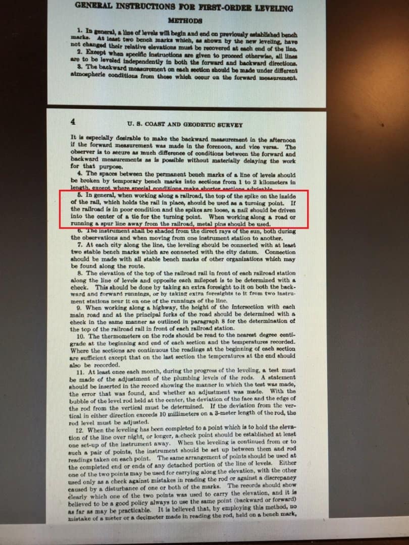

Special Publication 140.
Posted : December 31, 2015 8:18 am
Posts: 7465
Funny that the author considered the inside spikes preferable to those on the outside. I can't think of any difference between the two.
Posted : December 31, 2015 10:12 am
