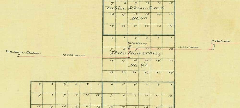

Andy Nold, post: 398510, member: 7 wrote: Owens built the west boundary of Block 45 from 11 recovered Parker monuments (and Parker was the first surveyor on the ground since Corwin never left his office in Austin for the original survey).
Just out of curiosity, what is the significance of the traverse to Van Horn Station that Dennis Corwin plotted on the map of his survey filed in the GLO as Map #2434? A portion of that map appears below. Taken at face value, it would appear to represent the means by which the index correction to Corwin's "North" by which the PSL blocks were laid out could be derived. I assume that this isn't a novel question, but that others have considered it.
Posted : November 7, 2016 7:42 pm

I'm not sure we're ready to make any final decisions as we are still gathering research and field work is being performed. And thank you for the contributions especially where Corwin is involved. With regard to the Southern Pacific reference in relation to Corwin, I am aware of the various names of the proposed Southern Transcontinental line. I recently was reviewing this https://www.loc.gov/resource/g4051p.rr004290/ 1867 map showing the routing of the H&TC (which was only built to South of Bryan at the time the map was compiled) and the centerline of the T&P labeled as the Southern Pacific RR in the vicinity of Midland. Also note the label to the north, "THE STAKED PLAIN", " Elevated Table Lands without wood or water, Across which a Route was marked by small stakes driven into the ground." The only inconsistency that I would point out is the the route of the Southern Pacific railroad which became the T&P was never routed through San Antonio. But that may well be shown to be confusion of the names on the part of Corwin's biographer.
The traverse you have shown is significantly south of where the statutory centerline was staked and looks like it generally follows along the tracks, or the "engineer's" centerline of the actual tracks. The statutory centerline predates Kuechler's work by a decade and since Kuechler tied his work to the Texas/New Mexico State Line and not the statutory centerline (which WAS held east of the 103rd meridian), the statutory centerline is not controlling and the "engineer's" centerline is irrelevant.
Yes, the traverse that Corwin represented in the detail that I posted above runs from the stations known as "Plateau", "Wild Horse", and "Van Horn" on the Texas & Pacific line that has been reduced to Northing and Easting components for purposes of calculations. The record of Dennis Corwin's work in 1884 suggests that he actually did run a traverse along the T&P Railway Company's track as stated in his connecting line in Crane County Sketch File 3c
http://www.glo.texas.gov/history/archives/map-store/index.cfm#item/19559
