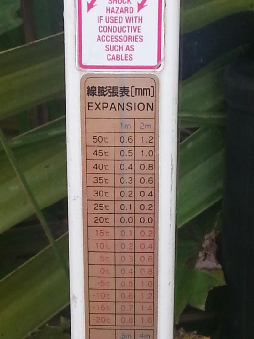

There's a table of temperature corrections on our digital level rod. I wouldn't think a fiberglass (?) rod expands or contracts. Does this correction address the movement of whatever kind of light beam the digital level uses, through the air?

No, the instrument functions like a camera, not an EDM.
I have never seen that, but I would assume there is some expansion/contraction if they put it on there.

The table on the level rod, is the temperature correction for the fiberglass level rod.
That's why some use an Invar Rod.

Invar also has a coefficient of thermal expansion for it as well, but, you are really smashing gnats with sledge hammers at that point. Just something to keep in mind if you are at the extremes
