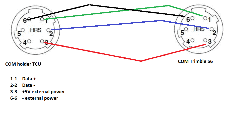

Hi! I wonder if it is possible to connect a TCU cable (set up to a holder) to the Trimble S6? If so, what would be the pattern on the pinout COM?
I tried the following scheme, but it does not work
