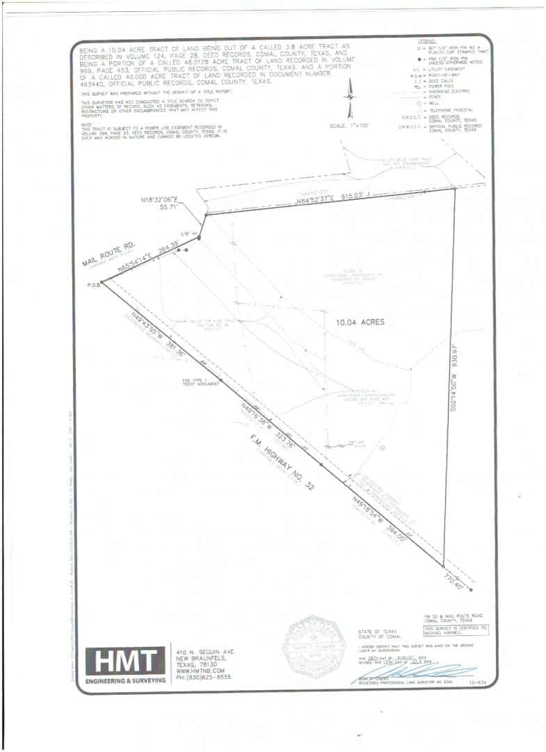

The Surveyor who Provided the legal description of our Property left a (possible gap) clause on Our Survey..This was between our Neighbors..
Previous Years,the same Surveyor had Surveyed the Neighbors Property...This was a 50 foot ingress/egress...
Is the Surveyor responsible to resolve this gap?

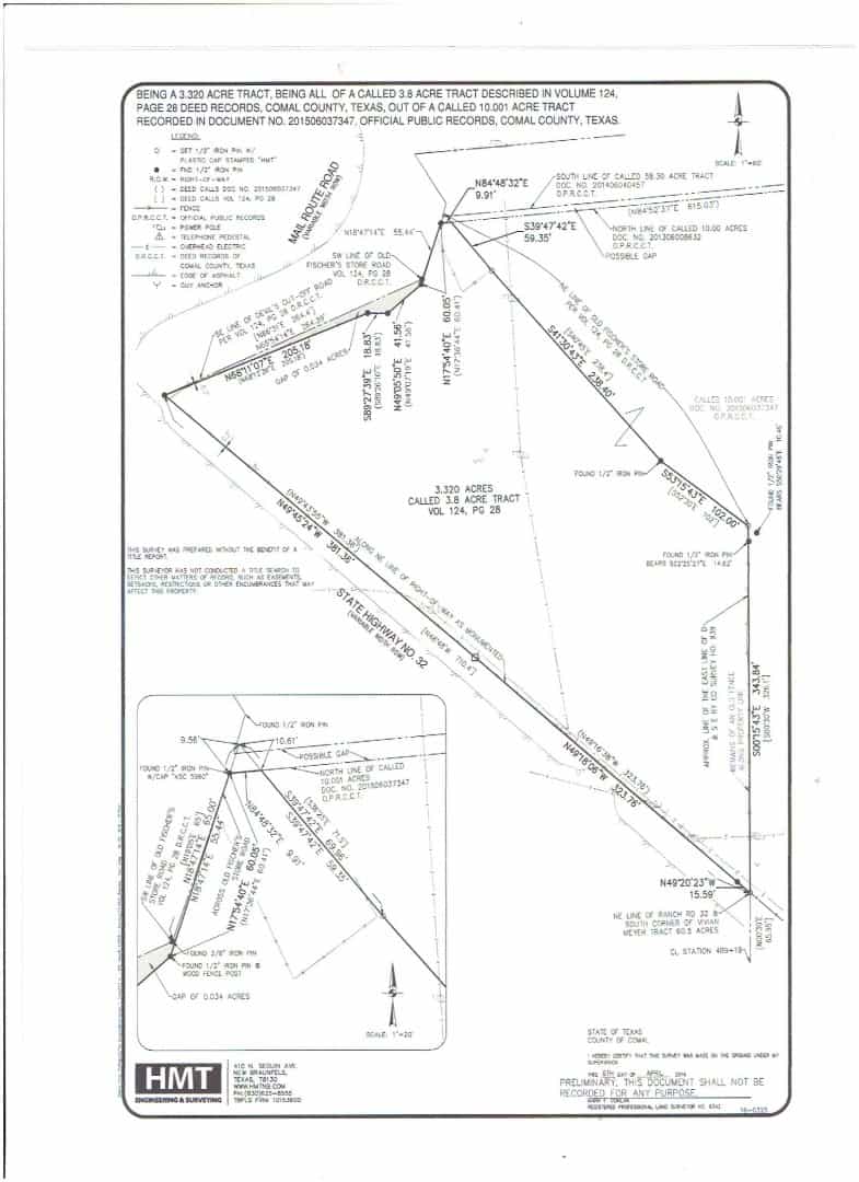

The Surveyor left a Gap between my Tract and my Neighbors tract.My Neighbors was Surveyed first.
The Previous Owners that Owned our Property, had a larger tract and wanted to carve out 10 acres out of it to sell.
The Surveyor Surveyed 10 acres out of the larger tract of land and we bought it.
The Surveyor left a gap between our Property and our Neighbors.
Should he of closed this gap.It's 2 to 5 feet wide,the Surveyor says he's not sure?

Legally speaking, there is no gap. If your tract was cut out of a larger tract, and your tract does not extend to the parent tract line, then the owner of the remainder of the property owns the gap.
Your situation is a prime example of why I hate planning and zoning. If there truly is a gap there, it's not your problem, and it certainly isn't the business of the engineer. If he doesn't want a gap there, he shouldn't have allowed it to be created years ago.

The intent of the Grantor will decide where the boundary exists.
A proper metes and bounds description should call for the location to exist with the parent tract when that is the intent.
Sometimes close is evidence of intent. When the gap is uniform and wide enough to be a path and can be proven to be a path, then the gap is a path.
I would need to research the chain of deeds form the creation of the parent tract leading to the creation of your two or more deeds and read each of them to be able to make any decision.
One of my latest projects covers several hundred acres of land that was self measured since the 1920s and the distances mean nothing as nothing relates to where anything is on the ground.
What is contained within fences is very close to what was granted.
Simply because a distance is measured from a far monument to the east and another was measured from a far monument to the west and there remains a gap does not mean there is a gap.
A gap would exist when the Grantor's intent created a gap.

Here is the Survey, please note the possible gap clause you may have to zoom in.. Also note the disclaimer on Survey, This Surveyor has not conducted a Title Search to depict matters of records etc.. Under the Texas Administration Code 663.13 it says your suppose to search the foot steps to find the History of the previous Surveyors...
The Surveyor does not take respondsibility and wants me to Pay Him to reset points and get a Real Estate Attorney to draw up a Boundary Line agreement with my Neighbor..
Posted : September 30, 2016 8:12 pm

I am not familiar with Texas law but I believe you are misinterpreting the wording located within the plat.
The note regarding the survey was completed without the benefit of a title report typically suggests no title report was given to the surveyor from a third party during the course of the project, usually by a title search firm. Sometimes these reports are given to the surveyor for high profile surveys such as Alta surveys or commercial projects with large loans/money involved.
Secondly the surveyor didn't state "no record research..." was performed during the project. He states "...other matters of record". The surveyors duty for a boundary survey is to preform the necessary record search (note I'm not saying title) to determine his professional opinion of the boundary only. He is not required to determine all easements, restrictions, set backs and other features that may effect the property.
Lastly, having not been a part of the project I cannot relate to any conversations or meetings you and the surveyor had during the course of the project. Nor have I seen or read any of the deeds or other records in regard to this particular instance. But by depicting the possible gap in the records I am assuming such evidence exists in the records. If this matter was discussed with you during the course of his contracted service, I feel he met his obligations on the matter. Again, this is without having seen anything relating to this property (other than the plat). If the records have created such a gap, he has shown it on his plat, and if it was discussed with you and no further steps were taken during that service, it becomes an unresolved area. It is also possible that there was an intent by original parties to leave a strip between the tracts. The image blurs on me when I try to zoom in very close and read details within the plat but sometimes we come across purposeful strips left between parent tracts and interior parcels. They are commonly called "devil strips" in our area. But I don't know enough about your case to know if that is even a plausible answer.
His suggestion of hiring a lawyer and getting a boundary agreement to dissolve the gap is justified and I'm guessing was probably at least suggested at the time of his original contract with you. Either way, depending on the terms of your original contract with him, it was an unforseen issue with the boundary. In the past or at present, you would have most likely seen additional cost in clearing the matter up.
Once again, everything I have stated is solely opinion and without benefit of seeing the property, the records and all matters involving your particular project. I am also ignorant to boundary law, minimum standards and standards of practice within Texas.
