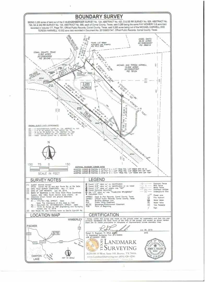

In 2000, the Surveyor cut out 58 acres out of a Parent tract,subsequently in 2012 the same Surveyor cut out our 10 acre tract out of the same parent tract..Our tract and the Neighbors tract are side by side..The Parent tract would have no intent of leaving a (possible gap) between our tracts...The County Engineer will only recognize a 3.8 tract that's within the 10 acre tract,if a Boundary line agreement is established.My Neighbor who recently purchased the property lives out of town and has not responded to my request. Since the 58 acres was established and then ours,would it have been prudent to close this 2 to 6 foot gap between our tracts?

The survey plat you have posted of the called 3.8-acre tract is marked "Preliminary." Do you have the final version?

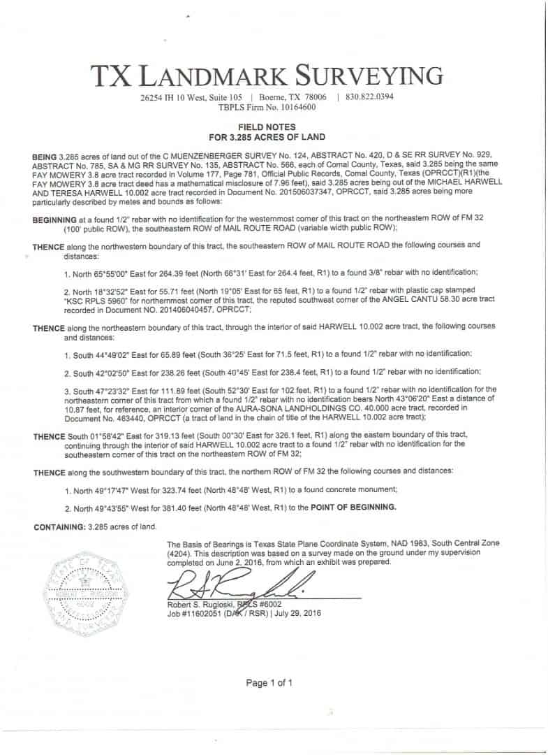

There is no way to come to a conclusion without seeing all the related documents, but how can the surveyor claim to have done all the neccisiary research and not know where the gap came from?
After the survey was completed the surveyor claims to have gone back "generations" in the record. Isn't it standard procedure to go back far enough to understand how the boundary was created? How can you come up with a proffesional opinion on a boundary location otherwise?

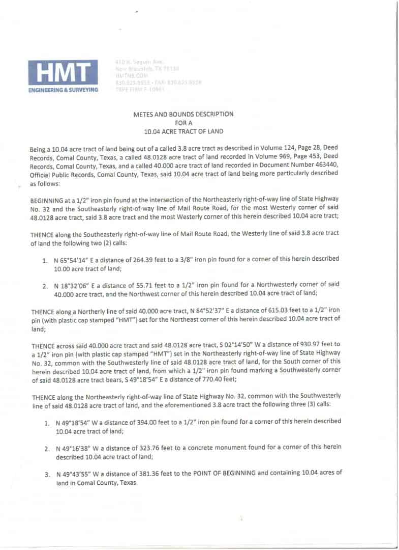

Just to satisfy my curiosity, I had to take a better look at the public records. So your 10.0 acre tract at the corner of Mail Route Road and R.M. Hwy 32 in Comal County, Texas would appear to be a part of that certain 279.3395 acre [sic] tract conveyed by Fay Mowery and wife, Sarah Mowery, to Douglas Barclay, Trustee in 1993. The 279.3395 acres was described in the Warranty Deed executed by the Mowerys by metes and bounds from a survey by the late Woodrow Cash, RPLS. Both your 10 acres and the land within the supposed "gap" would appear to be out of the 279.3395 acres.
So, the research is quite simple and can evidently be done entirely via the internet. The next step is to examine the conveyances by which Douglas Barclay, Trustee sold parts of the 279.3395 acres, and by which they they in turn were eventually conveyed to you and to the adjoining landowner.
A further simplification appears to be that Woodrow Cash made most or all of the surveys from which the metes and bounds descriptions used in the descriptions were prepared. I don't think that Paden Cash, who posts here, has any of the Cash records that he's willing to share.

Marked "Preliminary Survey" with note "Prepared without benefit of a title report""
It appears the surveyor reported what he found and hid opinion regarding it. I would say he was awaiting action by the owner and/or title company.
This survey does not create the prior problem, it is the opportunity tobegin to correct the problem.

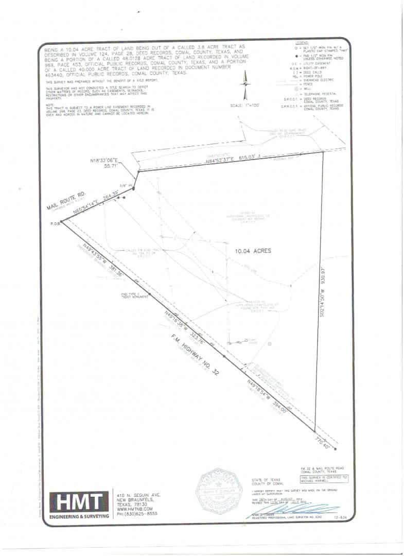

RPlumb314, post: 393486, member: 6313 wrote: The survey plat you have posted of the called 3.8-acre tract is marked "Preliminary." Do you have the final version?
This is the final Survey Plat completed by another Surveying Company based on a correction of the 10.04 tract..

Yes, after extensive research the County Engineer has finally agreed to acknowledge the 3.8 tract as being within the 10.04 tract except
now, I need a boundary line agreement with my Neighbor to the North.. All my information, has been based on what has been provided to me by Licensed Professionals..

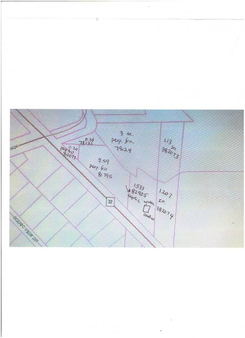

This all started with a Septic Permit application on a 1.53 tract that was part of the original 10 acre tract, part of (7) tracts taxed since 1937.
The County arbitrarily terminated all 7.. The Appraisal District to date has not responded to my request to explain..
