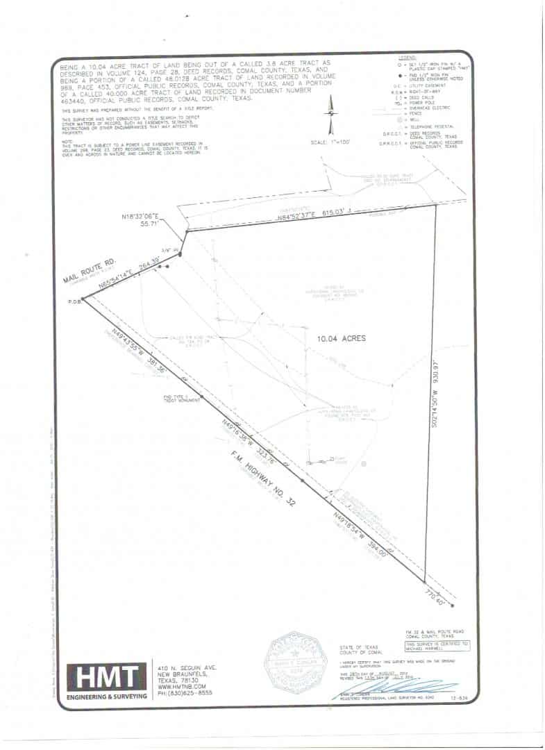

The original conveyance was a 10 acre tract,which did not meet the 2010 sub-division rule.Both Surveyor and Aura Soma received certified letters from the County indicating the tract was too small to meet the requirement,thus a Correction was made and filed..

This thread is an excellent example of how a surveyor often needs to consider what the problem really is instead of focusing on the way it is framed by someone with a vested interest in a certain outcome. This whole thread is really about finding an extra 0.02 acres of land so that a speculator who bought a tract of land described as 10.00 acres of land in the deed of conveyance to said speculator can divide the tract into two lots of more than 5.01 acres each.

Here is a update on the (Possible Gap). I retain the original Surveyor to establish a legal description of the gap.. Mr. Cantu the Neighboring Property Owner has determined he is not interested in a Boundary Line Agreement and has waved any interest's in the gap...
The 1961 metes and bounds establishing the 3.8 tract calls 65 feet to the Corner, incorporating the gap distance, it will now becomes 62 feet to Cantu Corner..
3 feet less... Does the new Survey of the 3.8 tract become 62 ft.? All joiners are at the same location.. Keep in mind, I am not a Surveyor.

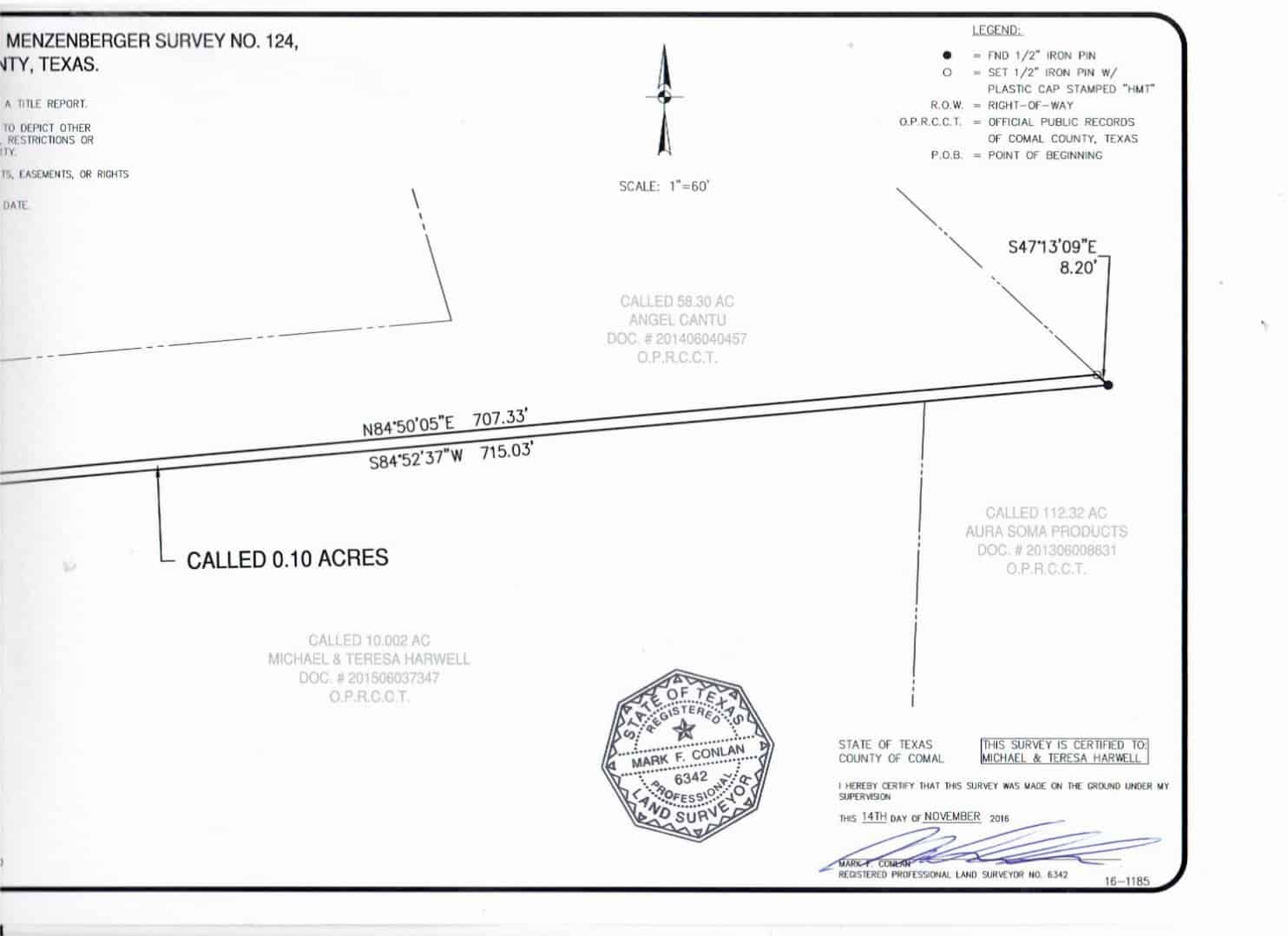

Here is the legal description of the so called (possible gap)..Incorporating the gap measurement to the Deed of 1961 metes and bounds measurement call 65 ft.it now overlaps into our neighbors Property by 3 ft.
Does an established corner pin and or joiner corners from previous Surveys take presidence over a measurement? We are at 62 ft.to corner pin,not 65 ft.which is called for by the metes and bounds?

Please see attached. I paid the Surveyor of Record to provide me this legal description of the (possible gap) ?
The County will not recognize this 3.8 tract if any part does not fall within the 10.04.Adding the gap, it now measures 62 ft.to common property corner not the 65 ft. depicted on the 1961 Deed.

Should this not been addressed many Years ago ? This (possible gap) needs to be cleaned up for us to retain the 3.8...
The possible gap is resolved with a Legal description but falls short by 3 ft. Measuring 62 ft. to corner pin not the call 65 ft.by metes and bounds deed 1961.Using the 65 ft.call it overlaps or goes into the Neighbors property
by 3 ft.
Does a property corner take presidence over a measurement call?

Michael harwell, post: 401919, member: 11340 wrote: Please see attached. I paid the Surveyor of Record to provide me this legal description of the (possible gap) ?
It appears that you have a competent Surveyor.
the 'legal description" describes the land, however it "does" nothing. your neighbor need to participate. (execute documents)
only the land owners can convey land and change the title.
